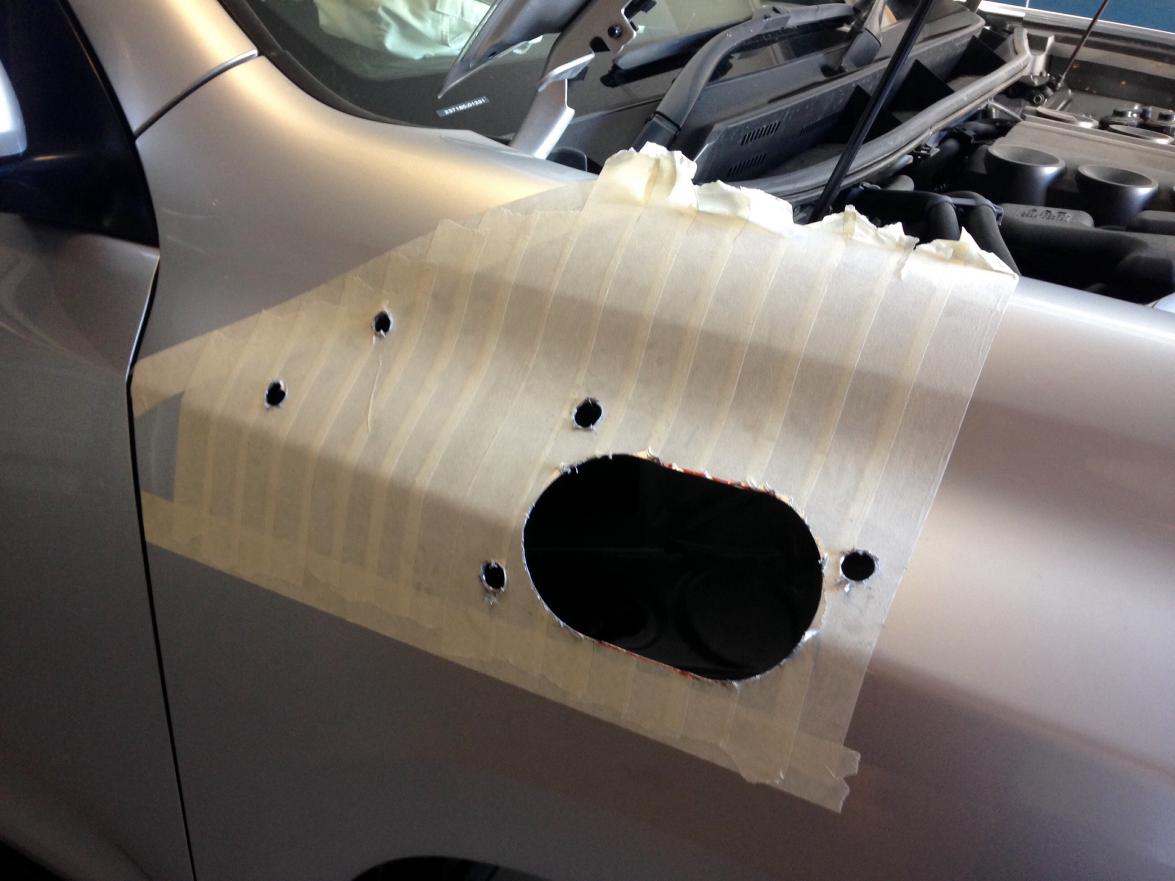

    I taped the template on and drilled holes with a step drill. Removed the template and drill the 105mm hole with a hole saw I picked up from tradetools for $40.
    I didn't use any masking tape or initial reverse cuts. Low speed on the drill and gentle pressure. I used the clutch on the drill so it would slip instead of jarr if it got caught up.

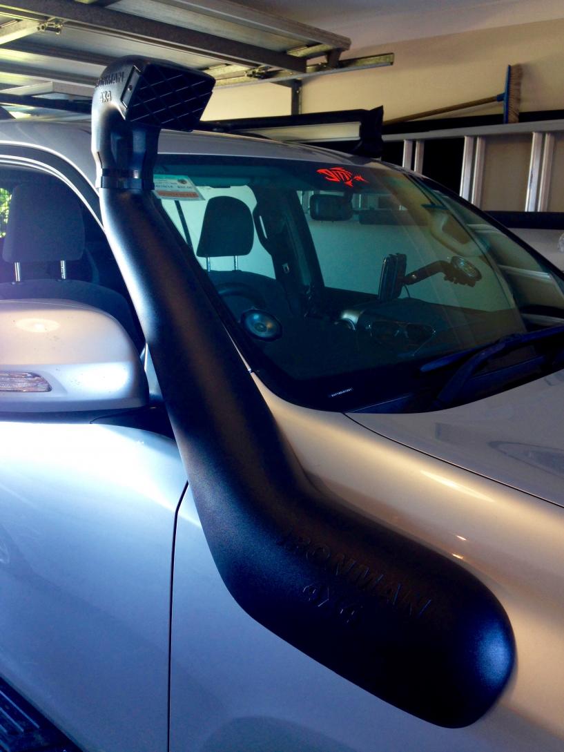

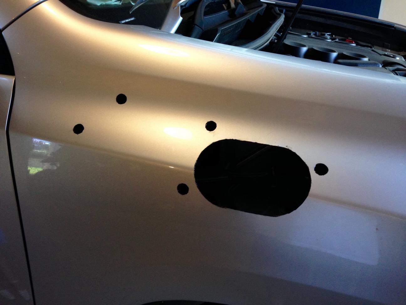

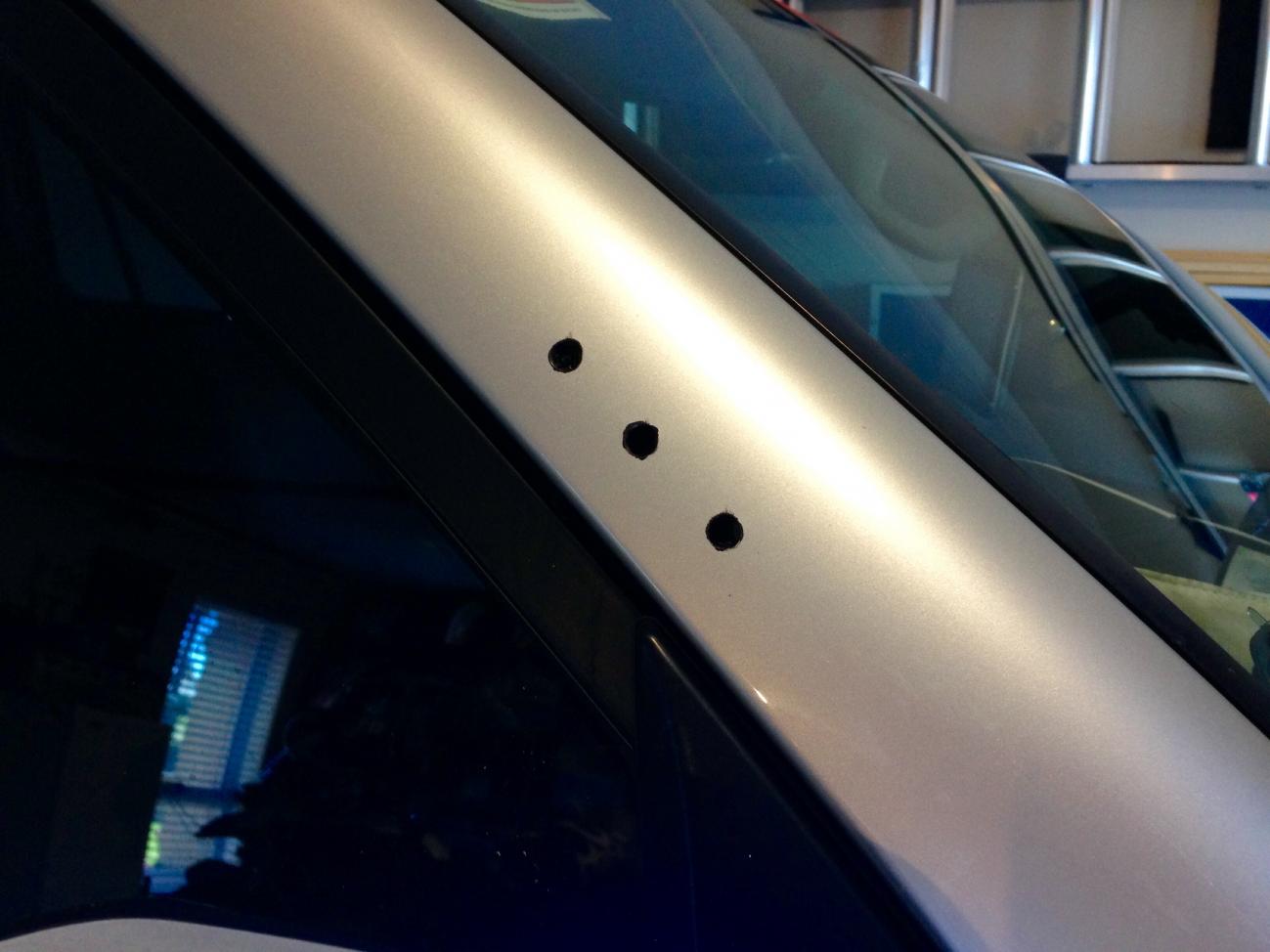

        • Hi all,
          Fitted an Ironman snorkel the other day.
          Pretty straightforward job really.
          Total cost was only $297.00 for the snorkel as I already had a holes saw I could use.
          Saved myself about $300 and did a better job than most 4wd workshops would (I've seen some pretty rough work by so called pro's).

          • Well done, and looks good. You have almost "motivated me to have a crack myself now, wheras before I was a bit hesitatnt. A couple of qustions please Jaymboze, if I may.
            1. What did you seal the cut metal with afterwards to prevent rust?
            2 When you drilled the ä" pilar upright, is there any risk of hitting an airbag or anything inside the pillar?
            3. When you connect the snorkel to the airbox inside the guard, do you need to use a special sealant to avoid contaminating the MAF sensor? I ghear if you use the incorrect sealant you can muck up the MAF sensor.
            4. Do you seal up the little drain in the bottom of the air filter box after the install or does it remain as is?
            5. Did the ironman instructions provide all you needed to know, or was there something that you would say to someone contemplating the same install?
            thanks so much for sharing your images and experience with this install

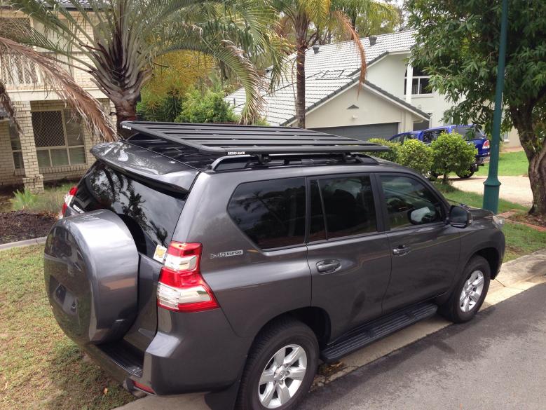

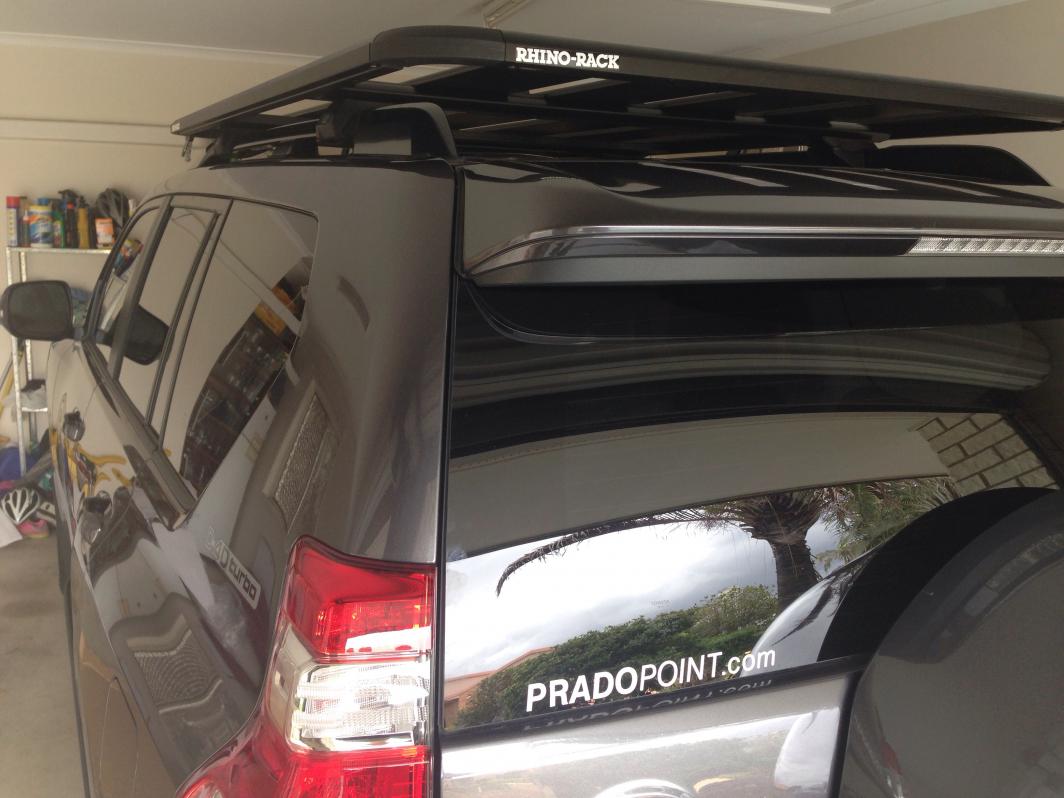

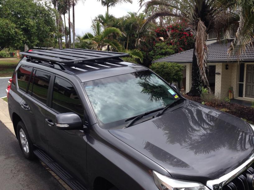

                • Ripped off the Rhino aero bars and whacked on my new Rhino Platform rack! Sweet as, and great price too!Click image for larger version

                  2014 150 GXL TD Auto graphite. CouplerTec, Rhino rack, maxtrax but still a work in progress...

                    • Originally posted by Matt Hannas View Post
                      Ripped off the Rhino aero bars and whacked on my new Rhino Platform rack! Sweet as, and great price too![ATTACH=CONFIG]18161[/ATTACH][ATTACH=CONFIG]18162[/ATTACH][ATTACH=CONFIG]18162[/ATTACH][ATTACH=CONFIG]18163[/ATTACH][ATTACH=CONFIG]18161[/ATTACH]
                      Good job Mr. I like it!
