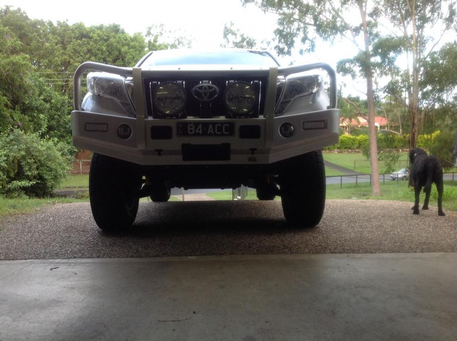

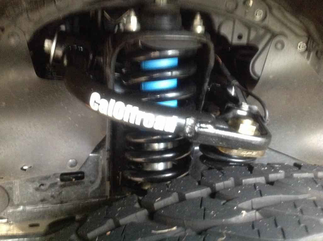

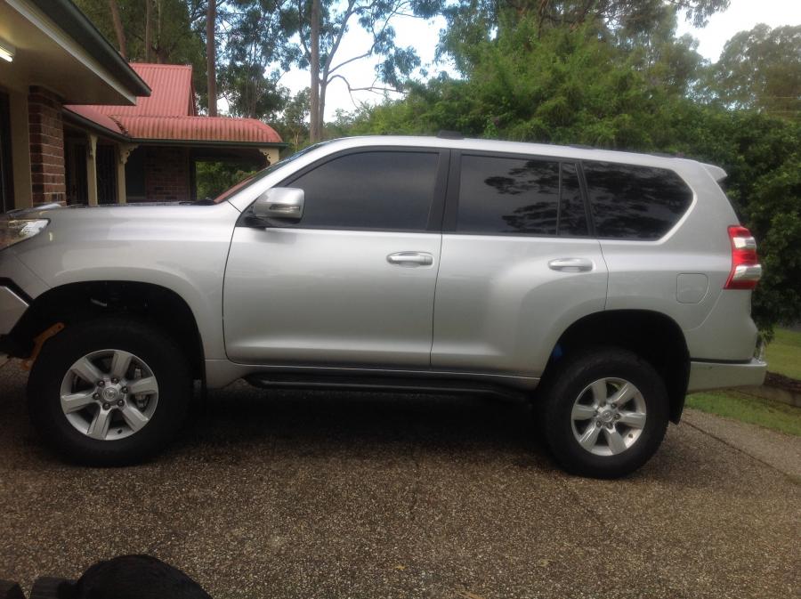

                              • Well, they say pictures are worth 1,000 words, and I'm feeling talkative today

                                My driveway is on a wicked angle, and I don't really feel like driving all over the lawn today for some wet reason, so the side on shot is a little odd looking.
                                Going to give Cal a call in the morning though, I have a feeling he has sent me the wrong springs or something, the back is about 40mm too high and the front is 30mm. I still haven't fit my drawers, but they sure won't drop it 40mm!! The rear airbags don't even come close to reaching either, there is a 30mm air gap below them. The front is on the lowest circlip too, so I think I just have the wrong springs. It's lifted the front up almost 80mm from standard before accessories, and the back up 90mm from standard. Looks awesome, but don't want the long term issues with this type of lift.
