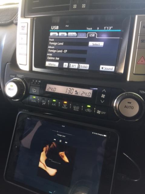

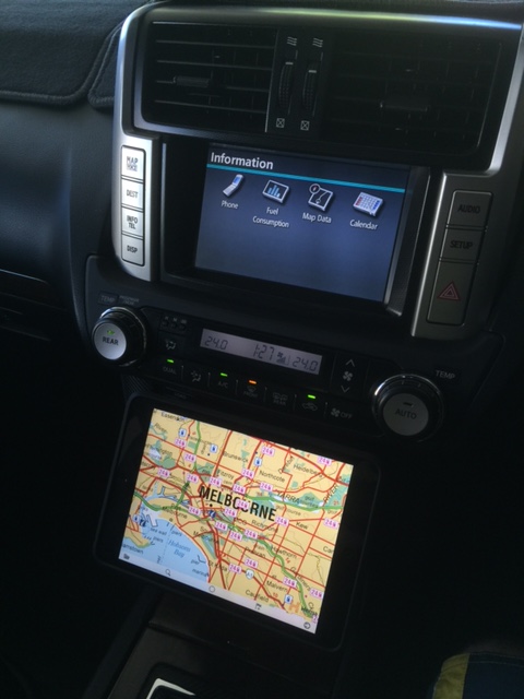

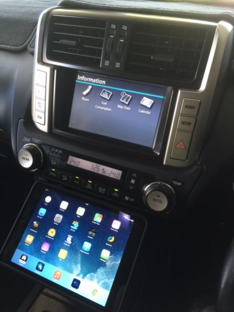

                  • Installed an iPad mini 2 (3G model with GPS) under the Climate control module. It sits in front of the stereo fascia. In a Kakadu this isn't too much of an issue as the audio display and controls are mostly on the top touch Nav display. Pics speak a thousand words. The iPad sits in a Spigen armour case and this case is attached to two adjustable plastic hinges. The hinges are then attached to the bottom of the climate control unit. This allows me to tilt up the iPad out of the way to get the CD/DVDs in and out. The hinges have adjustable friction so the iPad doesn't flop about. My phone still connects via Bluetooth for calls.
                    I currently have the iPad plugged into the USB port behind the transmission lever. Works a treat with the factory stereo as an iPod. I have a right angled black lightning cable to tidy things up a bit at the iPad end and will also hide the cable under the centre console trim back to the USB port. The special cable (had to get it from the US) is going in once I know everything is working correctly. So far so good.
                    Even though the factory Nav works well, this setup allows me to runs other Navigation software I've had on my phone (for years now). I have Tom Tom, Metroview, motion-x, and Hema. Even though the iPad sits low in the dash it seems to pickup the GPS signals quite easily. I tested this with my iPhone before I pulled the trigger on the iPad.
                    Other vehicle related things I can run; OBD diagnostics and Bluetooth TPMS (Fobotire).
                    All up cost was around $650 - iPad was $550 and the case, cable, and hinges $100.

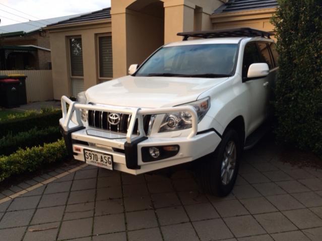

                        • Had a colour coded ARB Deluxe Bullbar fitted. Not looking so naked now....
Name:	ARB Deluxe Bar 1.jpg
                          Yabbie76
                          Lurker
                          • Looks awesome, Yabbie! Bet you're happy with the result!
                            Prado 150 D4D AUTO GXL with ARB Deluxe Winchbar, Brains' TG150 Transfer Case Actuator Guard, Bilstein/Ridepro 50mm Lift, Safari Snorkel, D697 265/65/17 LTs, Dual Battery Setup with REDARC Controller, REDARC Tow Pro, Toyota Tow Bar, Maxtrax - towing a Camprite TL8s fitted with GXL wheels and D697s.
                            • Thanks Joe, yeah I was happy with the result. The work and service from ARB Regency Park here in SA I cant fault.
                              It's addictive though, I'm trying to decide the next item on my wish list. I'm thinking awning, diff breathers, dual battery and some LED spot lights, all of which I'll have a crack at myself referring to all the literature on here. All in due course.
