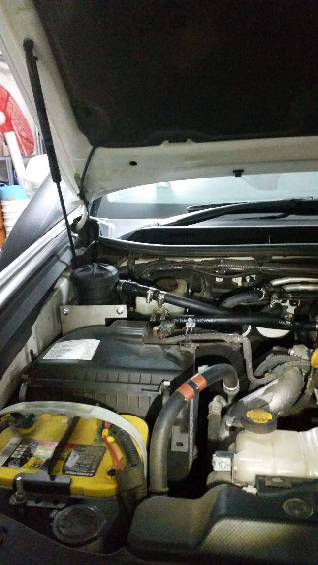

    • Fitted up a Provent 200 catch can.

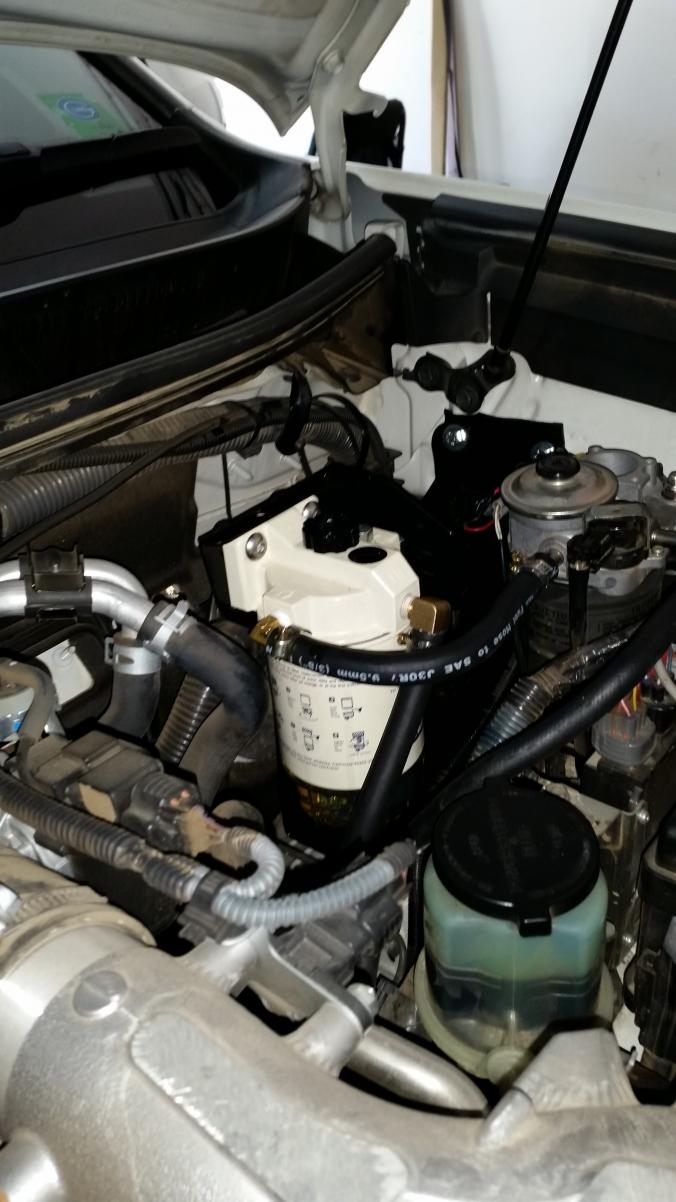

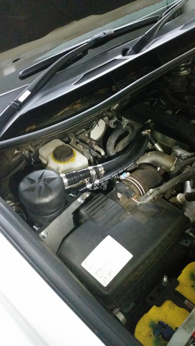

        • Finally got off my backside and fitted provent catch can with the western filters fitting kit and racor R20T filter with AMTS bracket kit.
          Both installs went easy as, probably 30mins for the catch can and 45mins for the racor filter. I might change the return line on the catch can to eliminate the steel pipe as others have done, just to make it that little bit neater.

            • Fitted my Provent over the weekend too. Same setup as above. Easy 30 min job.
              Got Western Filters to send me an oil safe hose for the drain hose, instead of the clear one they normally supply with the kit. That way don't have to worry about it breaking down and cracking.
              The bracket is nice and solid, I did give it a quick coat of black spray paint to help it blend in more with the surroundings. also put some insertion rubber underneath it and in between the bracket and the air box so no rattling. washers and nyloc nuts and the thing is solid as a rock.

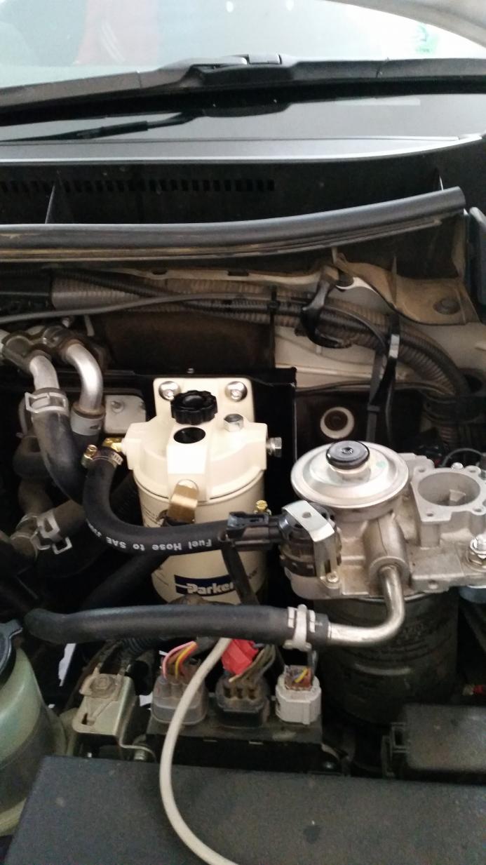

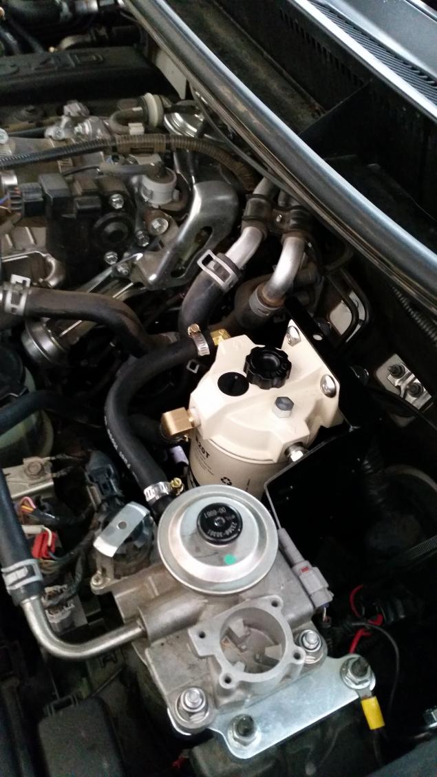

                          • Installed a second fuel filter using one of AMTS MkII mounts.
                            AMTS Mount - $130
                            Filter assembly on eBay - $120.
                            Hose and fittings - $15
                            TOTAL : $265
                            Fair bit cheaper than the $380 (+fitting) I was quoted by the various retailers of the Stanadyne FM100 filter kit.
