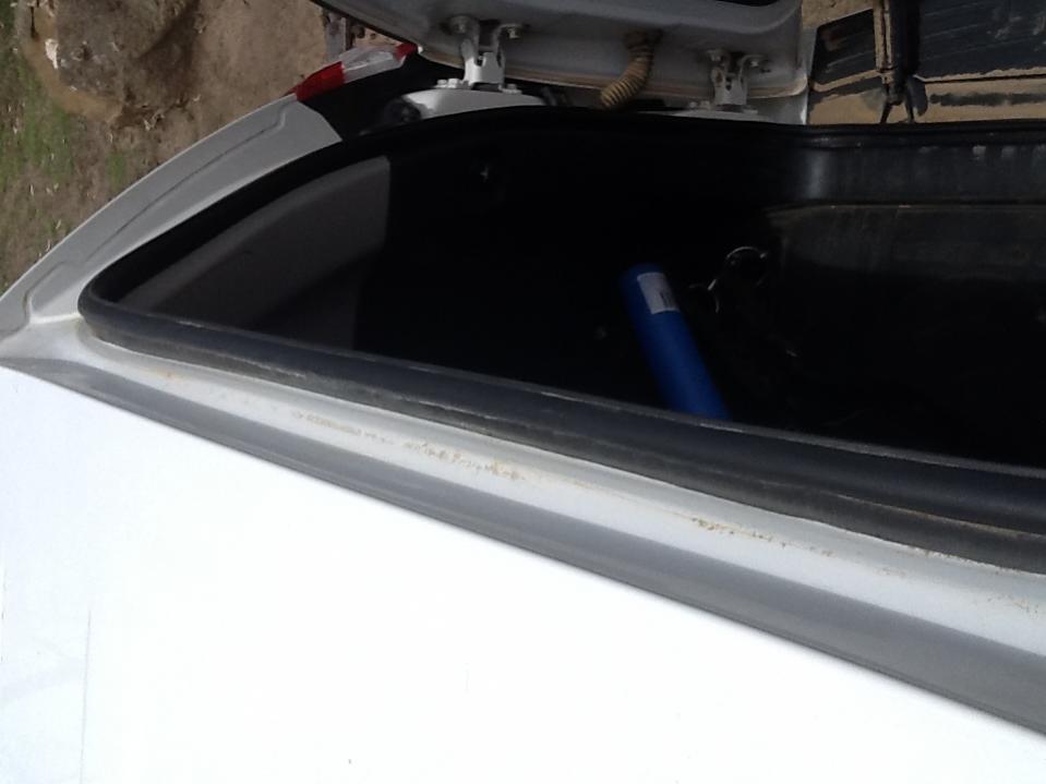

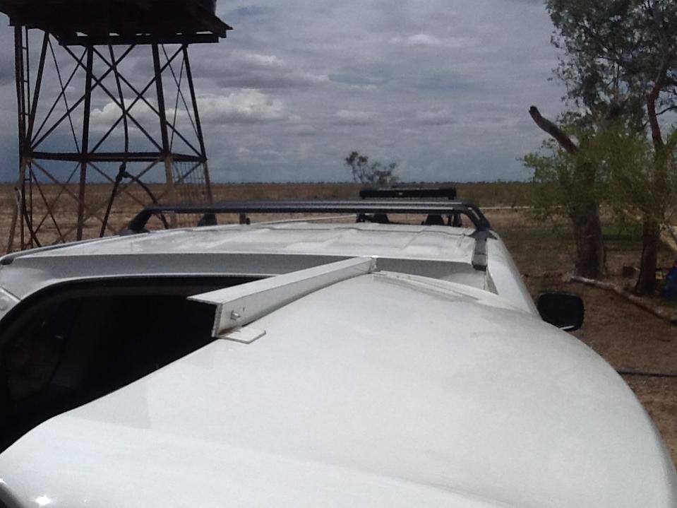

ID:	653025I solved the problem of bull dust build up on the rear door seal. It was driving me mad that a brand new 4x4 was unable to keep dust out so after a lot of research i came up with 2 solutions. 1 replace original seals with thicker ones that dont have holes (original seals have holes), 2 install a wind scoop on the top of the rear door to direct air flow in the cavity where the door meets the body (i used a length of 1" angle aluminum that matched color pretty well).
              It works great
              Bull dust used build up and drop down all over the cargo in the back when ever i opened the rear door, now it is dust free

              • I forgot to add that i got the seal from Clark rubber, about $60 for 4.6m only needed about 4.2m but better to have to much than fall short

                            [ATTACH=CONFIG]22301[/ATTACH]I solved the problem of bull dust build up on the rear door seal. It was driving me mad that a brand new 4x4 was unable to keep dust out so after a lot of research i came up with 2 solutions. 1 replace original seals with thicker ones that dont have holes (original seals have holes), 2 install a wind scoop on the top of the rear door to direct air flow in the cavity where the door meets the body (i used a length of 1" angle aluminum that matched color pretty well).
                            It works great
                            Ill try and add pics.[ATTACH=CONFIG]22302[/ATTACH]
                            That's a great idea. nothing worse than all that dust coming off as you open the door, straight into the boot.
                            How have you attached the angle to the rear door?

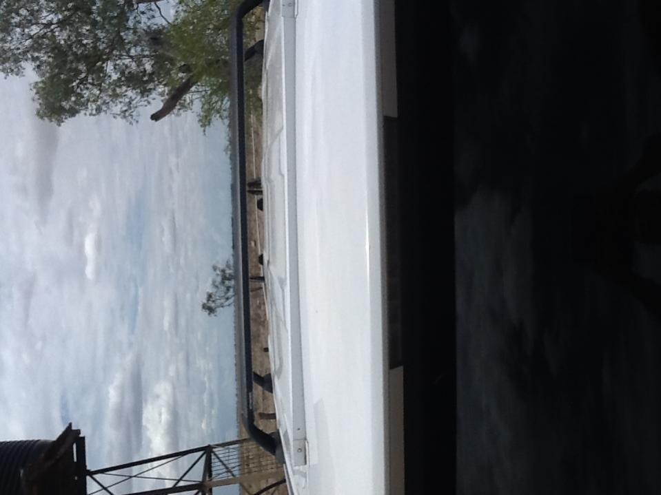

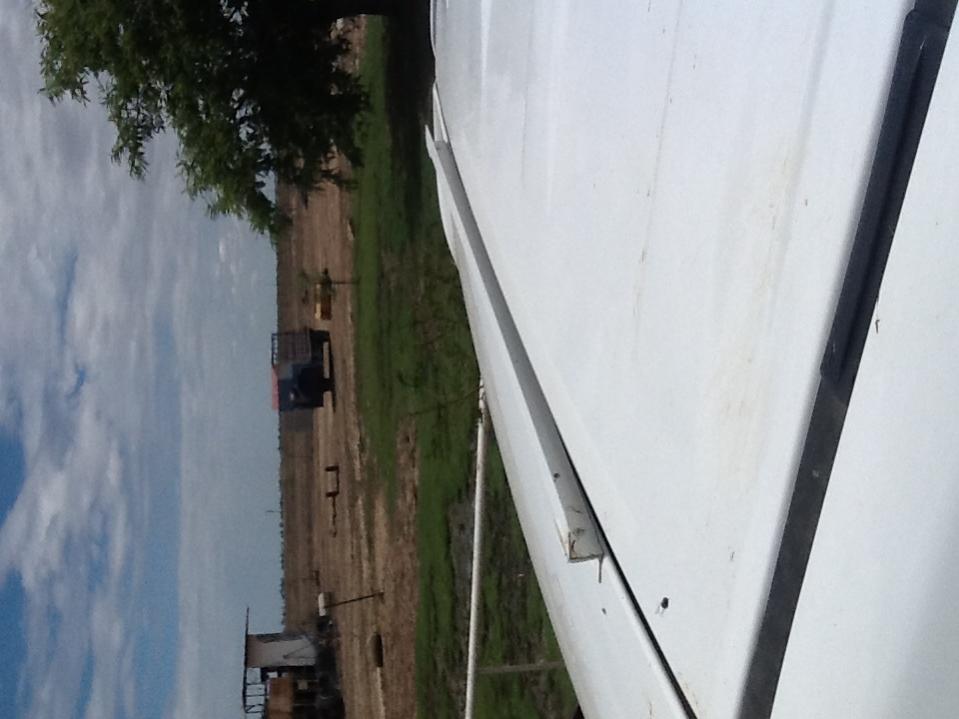

                            • Super glue is holding it very well, we have a grass hoper plague out here atm and they can't knock it loose.
                              I have shown a few other Prado owners and they are doing the same.
                              The other advantage is that it doesn't matter if the AC is on fresh or recirculate due to the tight seals
