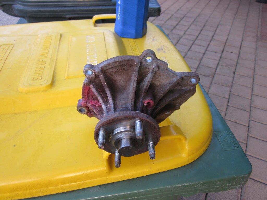

            • Changed out the water pump. Wasn't as difficult as I thought it would be.
