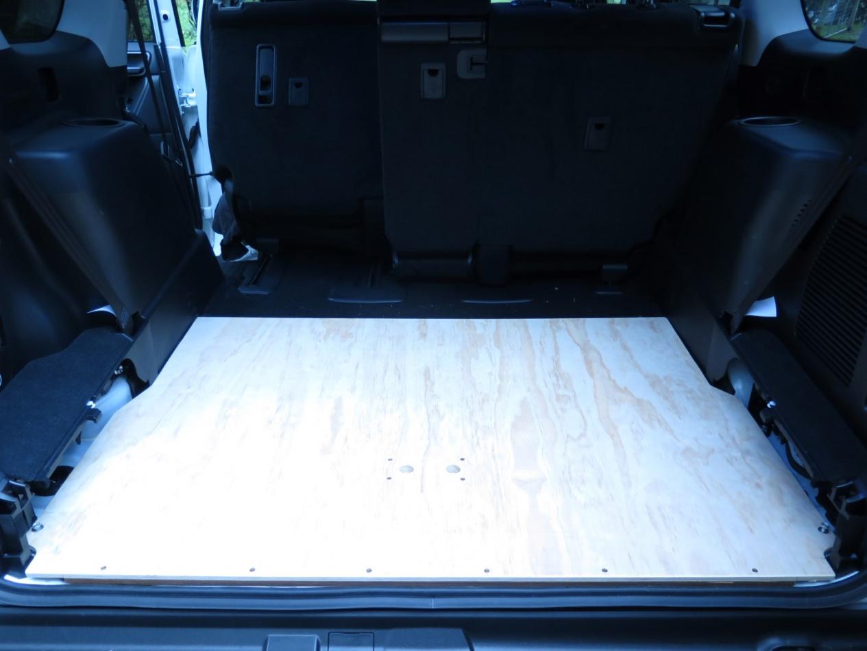

                • We recently purchased a new 2.8D4D GXL with manual transmission and today's job was to start modifying.
                  Took the rear seats out to free up some space and then made up a floor to protect the wiring etc that is exposed after seat removal. The floor will get a coat of sealant and then I'll glue some carpet to it. It's bolted to two of the seat mounting holes and a couple of smaller holes in the back corners.
                  Note the row of screws along the back edge only hold the spacer under the ply, they aren't fixed into the metal!

                  We had a false floor in our 90 series which I'll modify and install in the 150. It sits about 200mm above the ply and has a drawer system and fridge. The gap between the false floor and ply stores the tour tent, chairs and table etc.

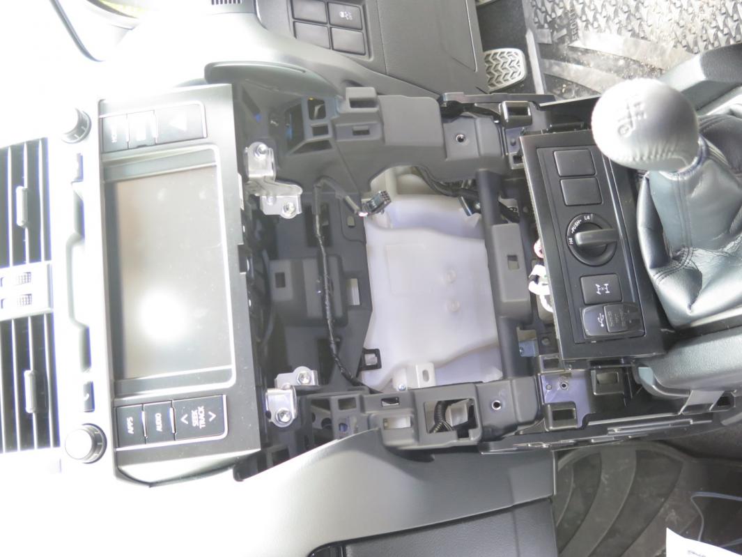

                  Next was to add a USB outlet and install the P3 brake controller. Always fun pulling a brand new car apart, my wife reckons she can't watch! Thanks for all the info on this site, made the job a whole lot easier!
