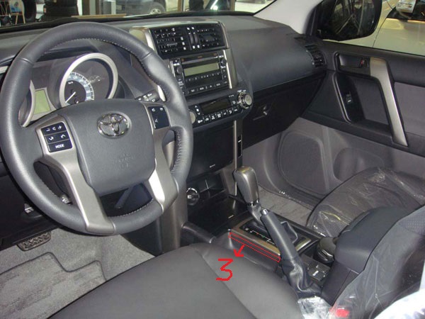

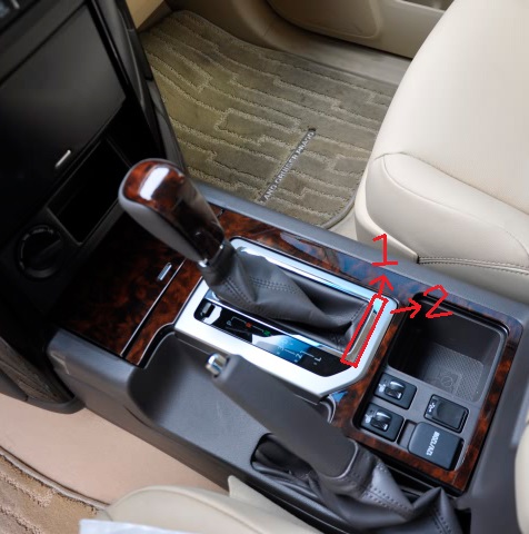

            The creaking noises in my case seems to be coming from the trim around the shifter area. The chrome trim that holds the leather and surrounds the shifter, the gray plastic area that surrounds the chrome trim or the whole black plastic area that is under the gray trim.
            If i push any of these areas they creak like crazy, specially the last one but im not sure which part is actually making the noises.
            1. Chrome trim
            2. Gray plastic surround
            3. Plastic under shifter
ID:	651865 (Spot 1 and 2)

ID:	651866 (Spot 3)
            Im sorry for the weird image file names. Hahahahaha
            I was thinking about spraying heck out of it with some plastic and electric safe lube on all those areas to see if the creaking noises go away. Havent tried it yet since i cant find that lube in my area locally.
              Sometimes, creaking is attributed to dirt build up. So if you can try and disassemble the trim from the centre console. Try spraying with silicon grease or maybe some carbon powder.
