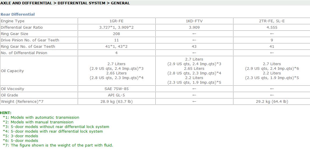

                The 5 door diff ratio is also 3.909 both manual and auto in diesel. The petrol is a little taller at 3.7 or something. Was reading all this the other day in my repair manual. The overseas model that have the ancient 5LE donk have a final drive of 4.5 or something which it very short. Must rev like buggery on the highway.
                Edit: Just found the page in my manual. Hope that helps.
                  [ATTACH=CONFIG]22864[/ATTACH]
                  Agree with this. I did a spreadsheet a while back to back calculate speed and RPM and I couldnt get it to work with 3.727. 3.909 works fairly close.
                    Nanbar, MacroP, thanks for that, certainly clears that up. I've obviously mistaken data I've seen on the ratios and confused the petrol ratio which is higher geared (makes sense).
                    So the three door almost certainly has the same drive train from engine to wheel as the 5 door auto 3 ltr diesel. Thanks, that'll help heaps when I start looking for 4.1 diff components to reduce my final drive by 5%. No one lists kits or parts for a 3 door.
