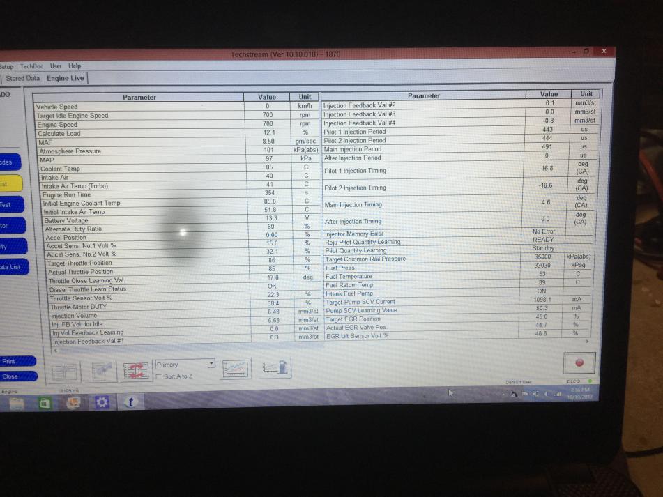

I recently bought a 2010 diesel auto 150 series with a holed piston, when I bought it the Traction control, engine light were on and 4 lo was flashing (no surprise right!)
The error code it was showing was for 2 injectors prior to rebuild
I have had the engine rebuilt (short engine only) by a mates dad who is old school (has limited experience about the tech side) and had new baileys injectors fitted and coded - the engine runs great but the Traction control and engine light are still on and 4 lo is still flashing
I ran techstream and my Smart scan and get the same error code - P1601 - which on techstream says "EEPROM Error - Injector Correction Value, DPF Thermal Degrading Record.
I cleared the codes using both techstream and smart gauge - both time the traction control light would disappear and then immediately re-appear...(ie back to all warning lights on)
Any clues on what else to do? - the guy who coded the injectors tried to clear the codes as well but couldn't - the injector values look ok (attached techstream screen shot as well) -
Inj 1 = 0.3
Inj 2 = 0.1
Inj 3 = 0.0
Inj 4 = -0.8
