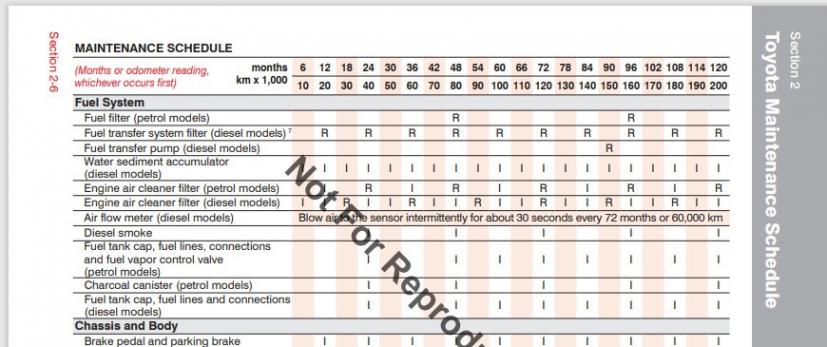

            Hi, I had a similar issue with mine and it stopped in the middle of the Gibson desert!!!!
            Turns out that there is a small filter on the fuel transfer pump in the rear tank. The pump at least is supposed to get changed at 150 00km.
            We had some dirty fuel which explains ours at 96 000.
            You can buy the whole unit for around $700 or just the small pump itself for around $200. I'm just guessing at the price as it was a while ago. I'd advise you checking with your spare parts person at a local dealership.
            Or google toyota prado 150 fuel transfer pump.
            The whole rear tank needs to come out to do the job. Good luck!!
