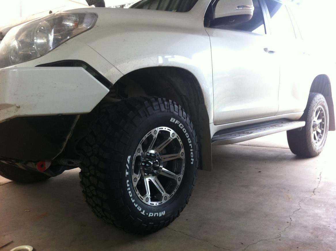

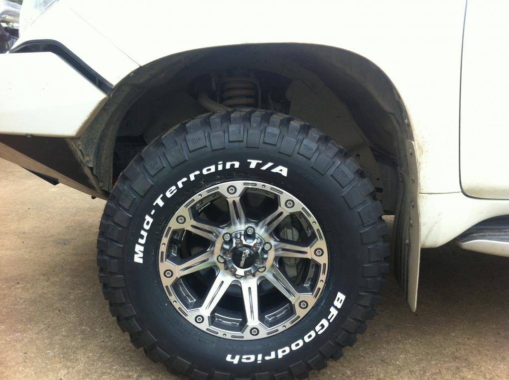

      after a lot of stuffing around with offsets and Mt tire options in 18' I went back to a 17x8.5 wheel with the km2's 285 70 17.
      and no rubbing.
      very happy

                Hi Stewydz,
                Im in the same situation at the moment... Looking to put either Mickey Thompson 275/70R18 or Cooper STMAXX 275/70R18 on the factory wheels and really don't want to have to spend the extra on wheels. You say that you tried all other options... Am I wasting my time trying to fit one of the tires above without rubbing?
                VXWesty
                [SIZE=1]2011 Crystal Pearl VX D4D Auto, MT ATZ 4 Rib, Full River 105AH / Redarc SBi12 DBS (TJM Tray), CKMA12 Air Comp, Alpine INA-W910R - PDX-5 - Type-R Speakers, Engel MT60FP, Rhino Alloy Platform, Foxwing Awning, Rear 12V Cig and Engel Socket, ARB Deluxe Combi Bar, Safari Snorkel, LF 240 XGT's + HID Upgrade, HB3 (9005) HID Upgrade, Bilstein / Lovells 2" Lift Suspension, Chip-It, Alpine PKG-RSE2 Roof DVD Monitors, Maxtrax, GME TX3540 + AE409L, Avenger TDS 9.5, ARB UVP, ARB Protection Steps.
                [/SIZE]
                • #98
                  Originally posted by VXWesty View Post
                  Hi Stewydz,
                  VXWesty
                  Hi westy
                  That was my first look too.! In the st max.
                  I have the cooper at3 in 275 65 18 on a + 18 offset wheel and they just touch the kdss arm at full lock under load.
                  Sorry mate but no way will that size fit on the standard wheel. That's the same size the tyres the arb prado has on it on their web page and they stated it had major issues too.
                  Even if you changed to a different offset in a 18' I think that they will still be to tall.
                  My 285s are a fair bit smaller then the 275 70 18 and they just clear the under edge of the bull bar. It's a arb Sahara bar.
                  I tried doing it cheap and going with a 17' steel but unless you go to a 0 offset which will hang way out and throw crap everywhere then nothing will work.
                  Dynamic claim that there's are made for the prado however their is only about 1 mm clearance of the calliper which I wasn't going to risk. Hence the 2nd set of alloys
                  Stu
