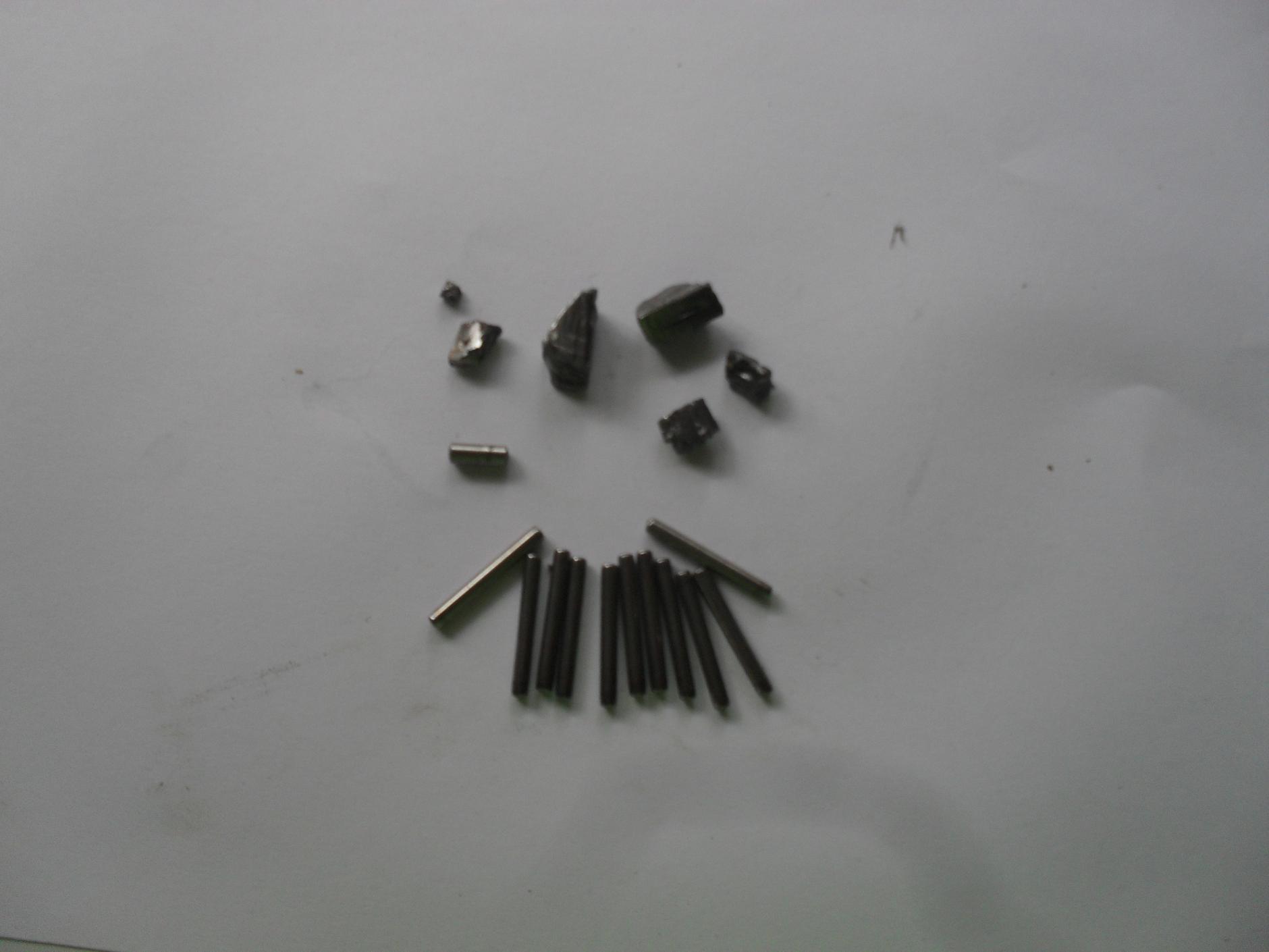

                      i removed the transfer case which was much easier then i thought and took the cover off which was quite easy also. i cant see any obvious damage but hears a photo of what was sitting loosly in the bottom
                        Photo is too small and can't see the details, but those bits at the top don't look good...
                          hopefully this pic is better, the bars at the bottom are all 20mm long

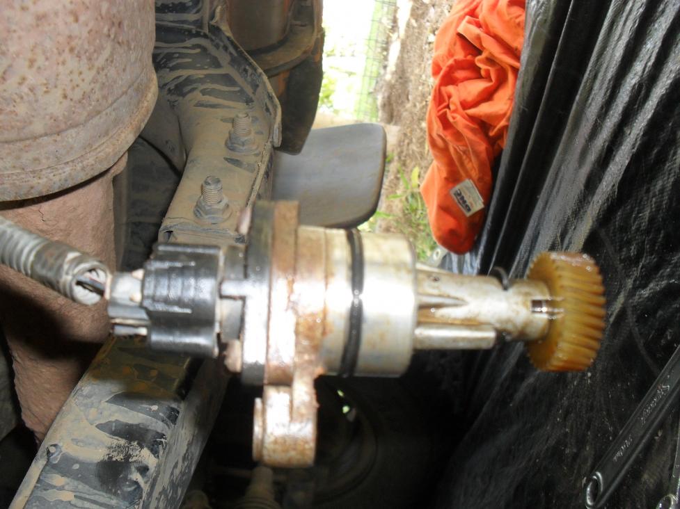

                            thanks roo, i got the transfer case off on my own, it didnt move untill i levered it off which was good. i was told that i would have to drop the transmission down in order to get to the top bolts but i was just able to get the 2 top bolts from inside the car with a spanner i cut in half. hopefully i can get a second hand 1 from somewhere soon and it should be easy enough to put back in. all i can seem to find around the place is auto transmissions with transfer case attached. i dont think the transfer cases are the same though. apparently the autos have electronic shift motors where as mines manual shift. what is this part that slides in with the 3 wires attached.

                              hears a pic
