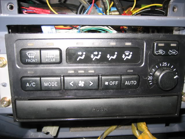

    I have a question for you guys. I live in Norway, and up here we use a lot of fuelheaters in the winter-time. I have also installed one of these, and it works just fine. But I have a problem, I have the automatic climate control on my 2001 Prado 3.0 D-4D and the fuelheater is supposed to send a 12 Volt supply to power up the fan/climate control unit which it does. And there is my problem, I do not know where the power supply need to go? As far as I can see there are several wires which supply the HVAC unit with 12V and I cannot find out which one I need to hook up to so the fan starts up and heats the cabin.

    A picture of the model I am talking about. Up here it`s designed for left hand driving so the buttons are opposite from yours
      The webasto is designed to operate the heaters fan motor, I assume you have installed
      one of the hydronic units, ie thermo top?
      I would not interfer with the current heating and air conditioning controls as would need
      to splice into the power to the fan switch, it would most likely be easier to access the
      the fan unit and just connect to the fan motor.
      Honestly these units are designed for camper vans, boats, trucks etc where your living
      or at least sleeping overnight, don't really see why you would need to heat the Prado
      interior unless your living in it?
