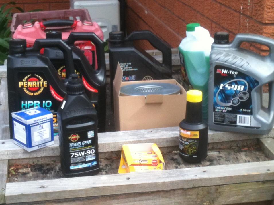

lots of $$$ in parts and oils but also saved getting charged 4 hours of workshop time,
( how much an hour do they charge at Toyota these days ?) plus I know it's done right with the proper grades of oil in all the right places.
Surely they could have found an easier spot for the engine coolant drain plug!
