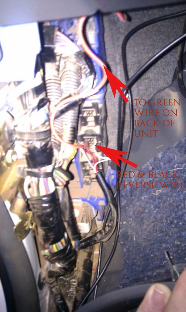

                the reverse sensor wire on back of unit needs to be run to the reverse light wiring on your prado for it to enable headunit to go to reverse mode when u chuck in reverse, grab a test light and you will find the wiring you need in left hand side kick panel. cant remember what colour the wire was but can have a look if need be. I got lucky on the 3rd wire i tested i found it
                reverse cam wiring is easy as and takes 5 mins wiring down passenger side, trim just clips off. i wired my cam to the reverse light wiring at rear so camera would only be on when in reverse.

                edit.... picture of left kick panel wiring and camera install,
                sorry for crappy picture, location of reverse wire you need to tap into with green wire from back of head unit.

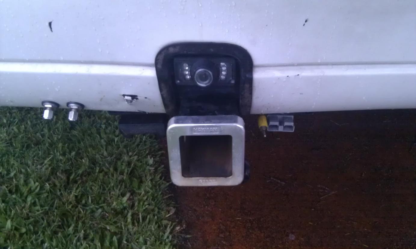

                camera doesn't have to be screwed at all doing it this way, just unscrew 2 bolts under rear bumper so you can flex bumper out to put cam in. does sit a little higher with guides on the screen but is perfect spot for reversing back onto my van. extra video plug in pict is for caravan reverse camera which i run through the AUX on unit which i can have running while im driving.
