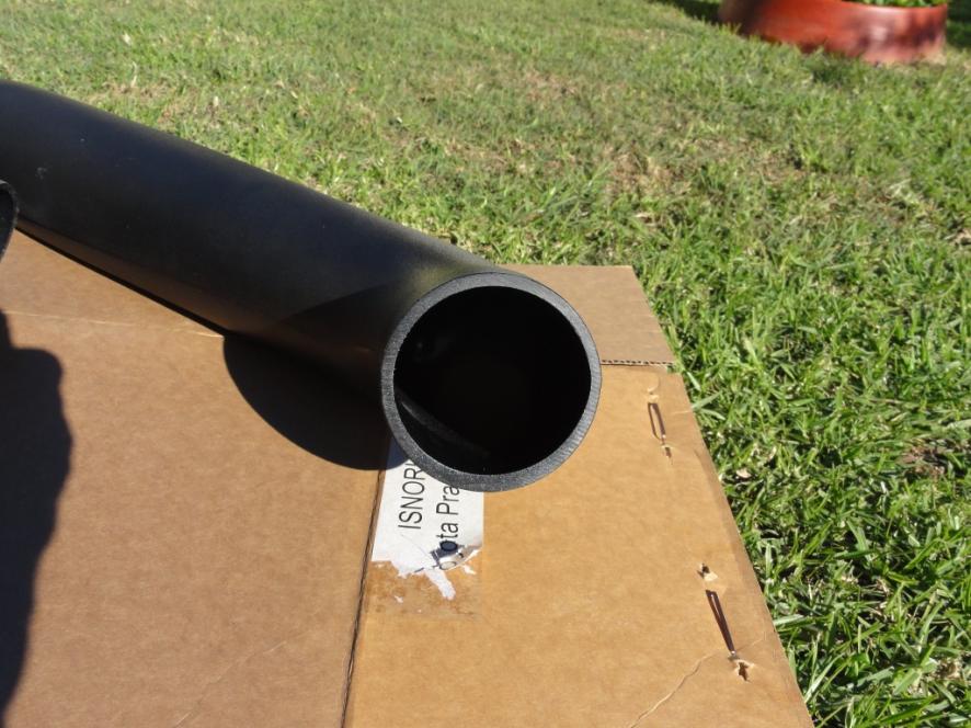

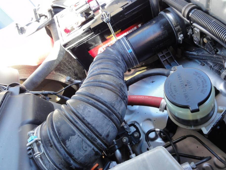

This shot shows the thickness for the snorkel which is around 5-6mm, very solid.

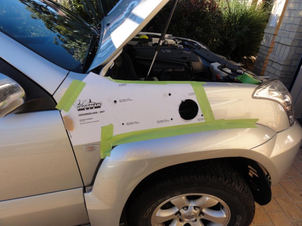

Template attached to the car, the large hole was good but the smaller holes were a little out, not a real problem though.

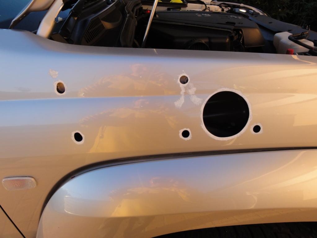

Once all the holes are drilled make sure that you debur them and apply good quality paint to prevent rust, I used kill rust galvanised primer
