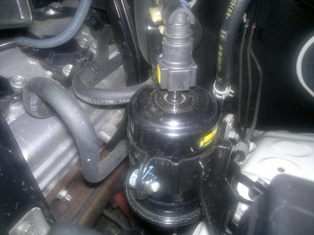

                  Just checked mine all seems ok no fuel smell no moisture. I hate those plastic attachments, I havnt even looked at the filter before but its the same set up commodores use only theres are just above rear diff, prick of a spot use to get covered in fuel when ever I changed the filter. I wonder if the old tool I had for the commodore will fit this one ?? will have to see if it fits next time the filters due for replacement. Not sure what would have caused it to come off after a week of running around ?? Would have though if it wasnt on properly from the service it would have been leaking from day one ?? Bazza was it the one under neath or the top one that come off ?? I dont like how they just swing around on there, seem so loose..Maybe it wasnt clipped on properly from when it was done and just a bit of vibration has made it come write off ?? You would think it would have been seeping if it wasnt on properly ?? Cheers Steve
                    Crooza, this is where it is. Sorry for the crappy quality its a dark and just took using phone not a real great flash. Sorry I cant put the direct picture on here as the little thing/bar or what ever you want to call it has gone missing that i use to use to add pictures and things, not sure where the hell its gone ?? any ideas http://i1019.photobucket.com/albums/...3032012710.jpg
                      Picture Of Fuel Filter

                          Ahhh, the 120 has the fuel filter under the bonnet, unlike the 90 where it is under the body onthe chassis rail. Bit of a silly place really, So where is the 150 fuel filter, has it been put back under the body or is it still in the engine bay.
