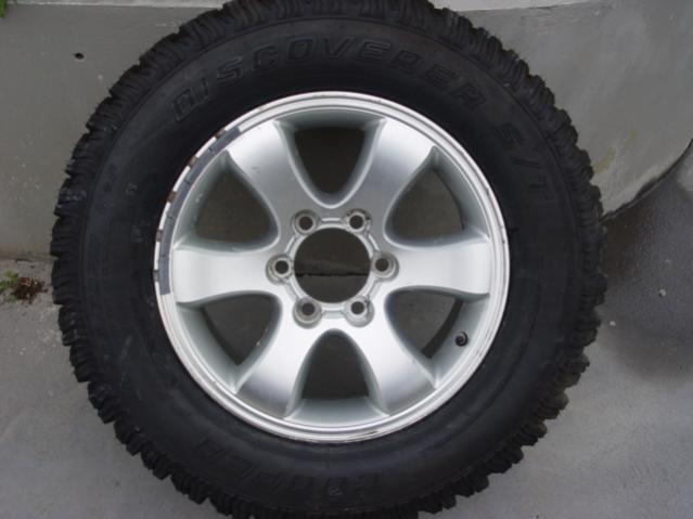

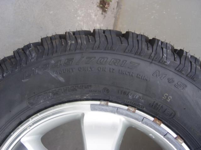

    Never have I seen so many wheel weights added to a wheel to balance it ?? Now this is either bad for the coopers or the rim is out of whackClick image for larger version

    Forgot to add this was on ebay for sale, Id be a bit worried if this was my rim and tyre ..........Cheers Steve
      Maybe the tyre needs to be rotated on the rim, or the tyre is rooted. If the rim was buggered it would have run out and you'd never be able to balance it.
        I've seen that before on a MT tyre. The sales person tried to claim that MT's always needed balancing like this. The bloke pushed the matter and it turns out it was a bad batch. They gave him a replacement set that balanced up fine.
        Mike
          It is the tyre, Cooper and BFG are having problems with their tyres ATM, as they will not ballance up properly, this has been happening now for the last 4 months, which is probably why BFG is hard to get ATM, they are waiting for them to sort it out.
            So the point is, do not buy that tyre & rim, as the tyre is obviously faulty.
              Looks like going by croozza's reply its more then just that one. I wouldnt be impressed with that amount of weights hanging off the alloy rims, looks like shit..........Cheers Steve
