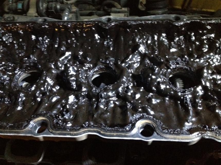

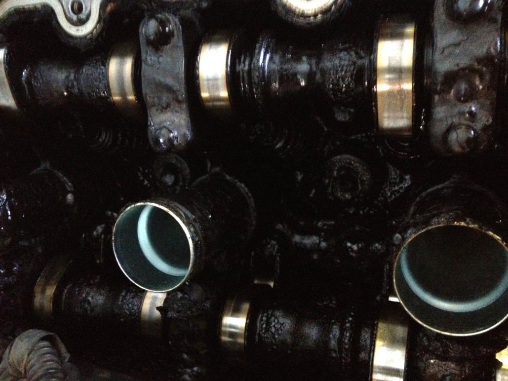

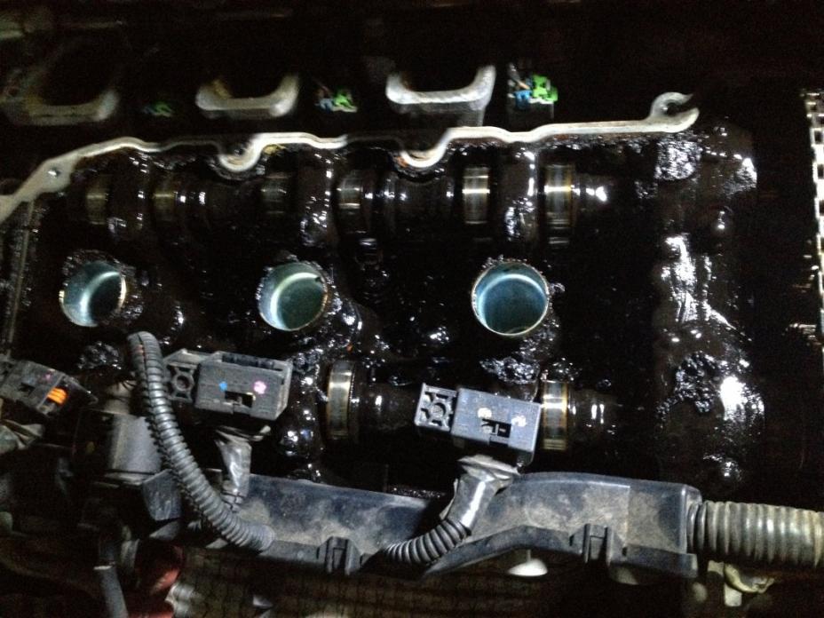

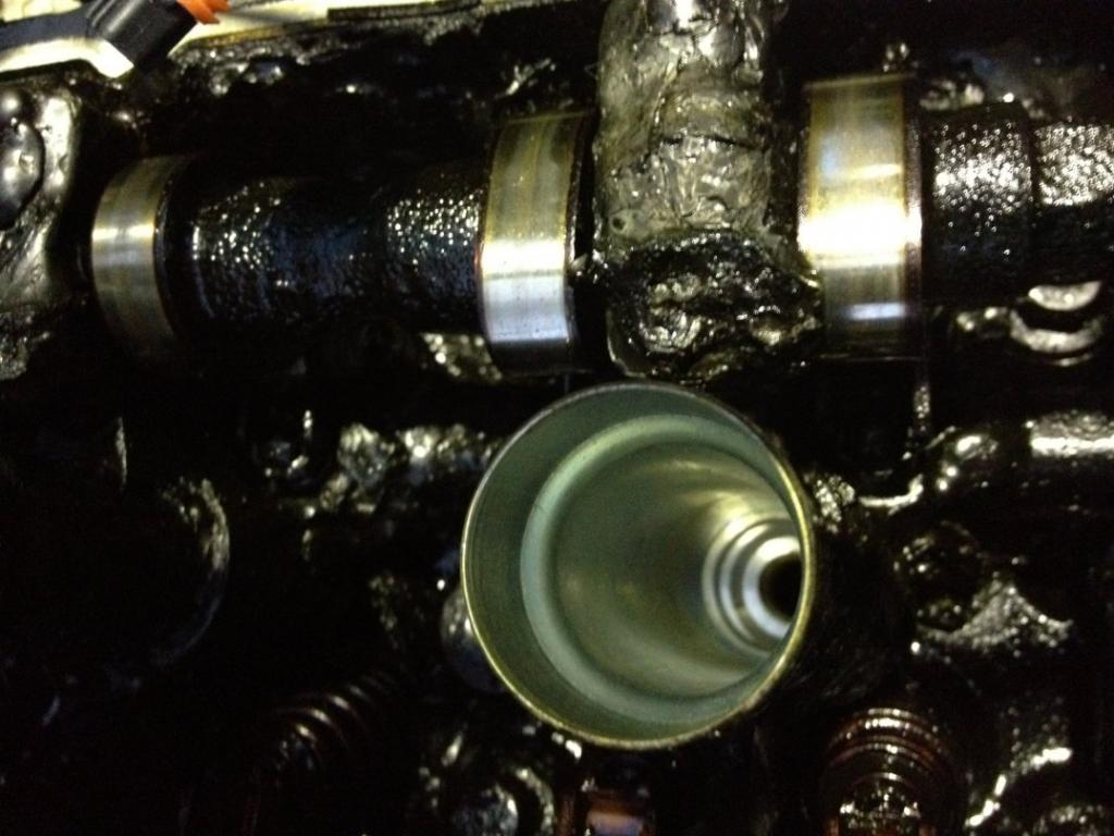

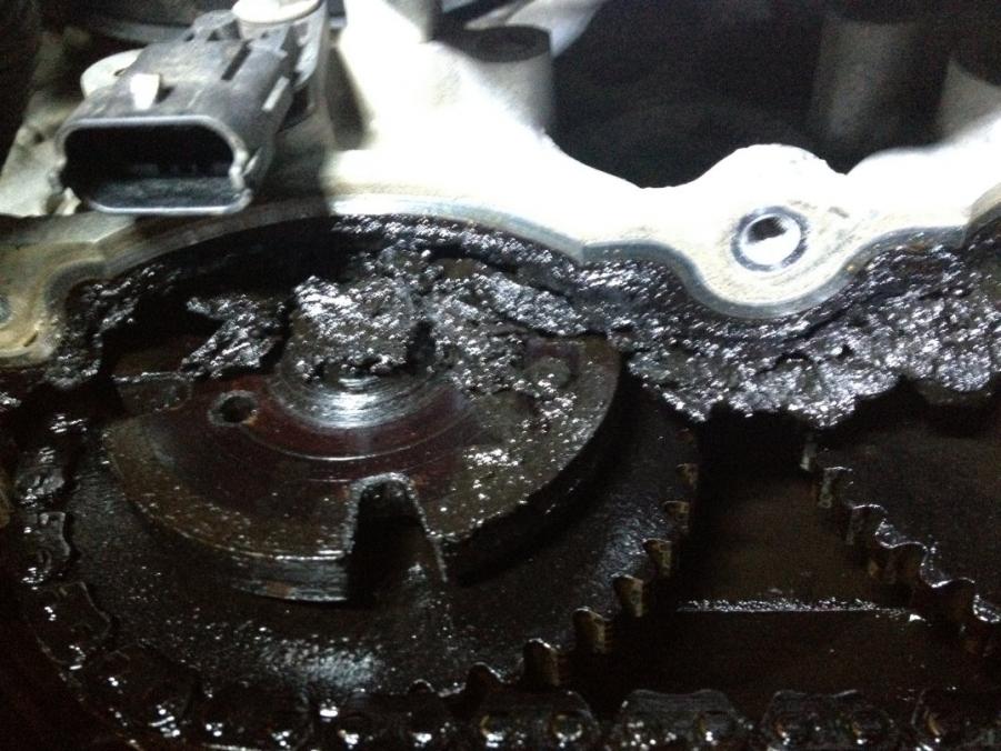

    A 2009 Rodeo 4wd turned up at work today. Vehicle has 93,000kms on the clock.
    Turns out it hasn't been serviced since 12,500kms, and that was its first service!
    Owner said it was "a bit sluggish for the past month or so and then the oil light came on".
    Vehicle stopped soon after and was flat topped to the workshop.
    When I removed the rocker covers the other guys came over for a look. Much discussion ensued! Imagine what the oil galleries look like! No wonder the oil light came on. Zero oil pressure tends to make that happen!
    I did a comp test on the RHS bank. 0 psi on all 3 cylinders.
    Comp test on LHS bank. 25 psi average.
    Owner is up for about $8000.00 to get it going again.
    For the kays done, it would have cost a bit over a grand to service the vehicle by the book if the owner had gone that way. Vehicle would have run better and used less fuel in that time too.
    I think pics and outcome, clearly show the false economy of not servicing your vehicle.

              I'm not very mechanically minded, so can someone tell me what I am meant to be looking at in those pictures?
              Did someone say 'sarcasm'?
                Just needs a top up by the looks of it...

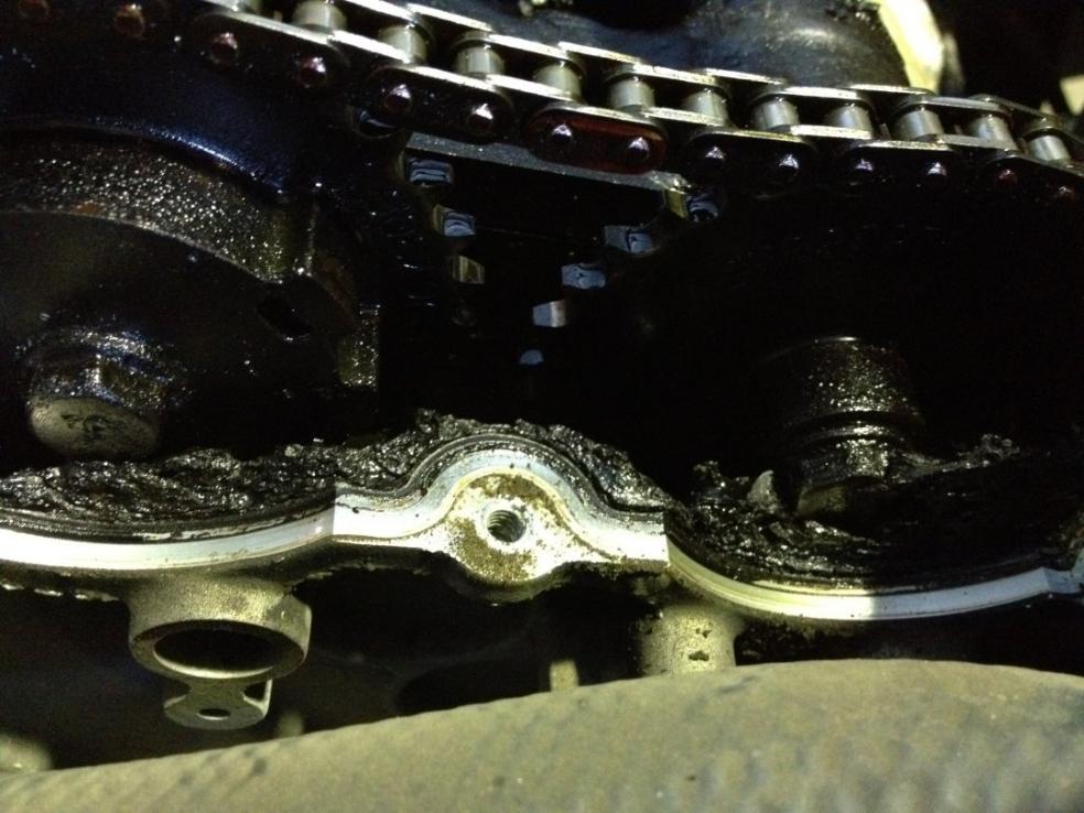

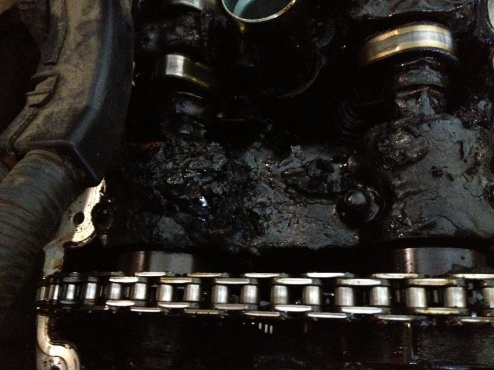

                  Another one came in today. Same issues, same model vehicle (2wd this time) and same lack of servicing. This one has done 134,000kms and has not been serviced for the last 42,000kms. It is a 2007 model.
                  This job will cost the owner about 70% of what the vehicle is worth. That has got to hurt IMO.
                  Piccies attached.

                        I also have this issue, have a customer at work's Hilux with 2.8 Diesel, came in because it didnt turn over.
                        After figuring out it wouldnt turn over, draining about 1.5-2L of sludge from the sump, removing the head and finding nothing obvious, pulled and stripped the engine, found No.4 big end bearing welded to the crank.
                        Obviously not service or even checked the oil for a long time.
                        Rebuilding as cheap as possible (I dont like it, just do what I'm told) but when stripping the engine, it became obvious that a very similar scenario. (paint marks on head bolts say the heads been off before, blue sealant on the sump says its been off before, aftermarket oil rings say the rings have been done, and wrecker markings on the crank say it has been replaced before as well) All in all a fairly depressing situation for a vehicle with only 180.000 odd km on it.
