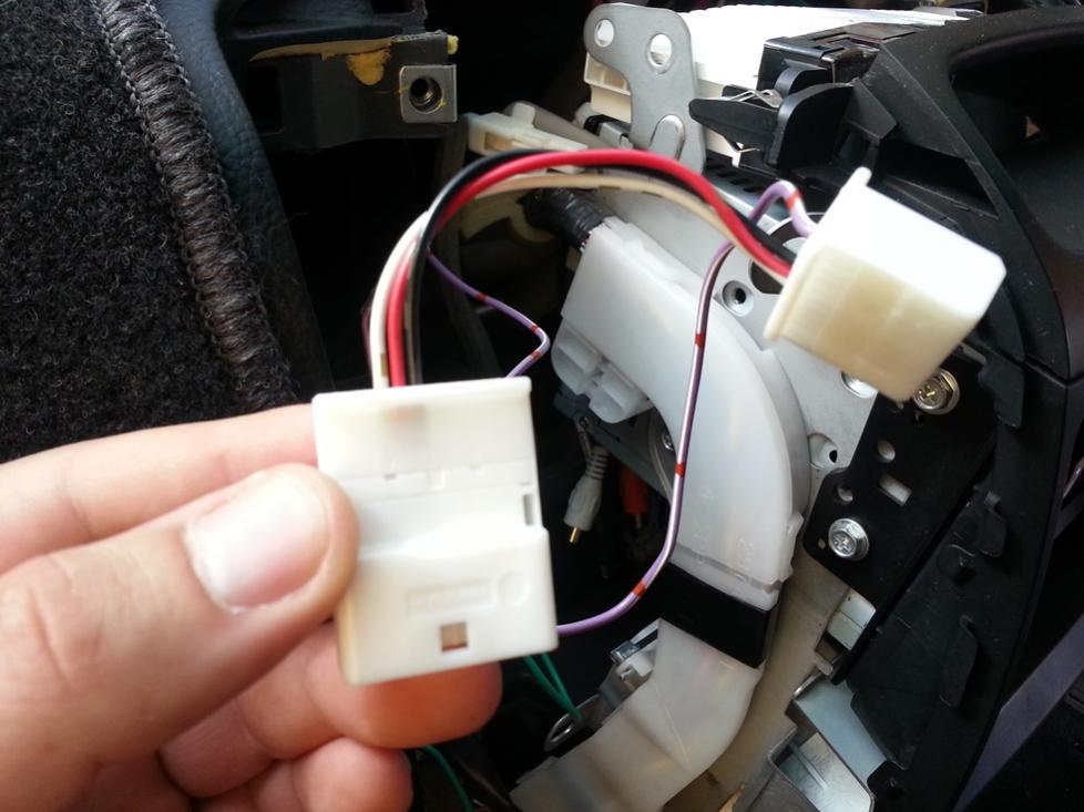

                              Hi All,
                              I think I made a discovery! There are 4 looms which plug into the back of the 6stacker/BT stereo. Two of them are this...

                              • #30

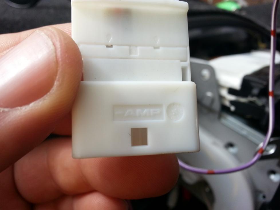

                                Which is simply a bridged connection between the two plugs. However one of them is labelled 'AMP' and has a purple coloured wired leading out from it.
