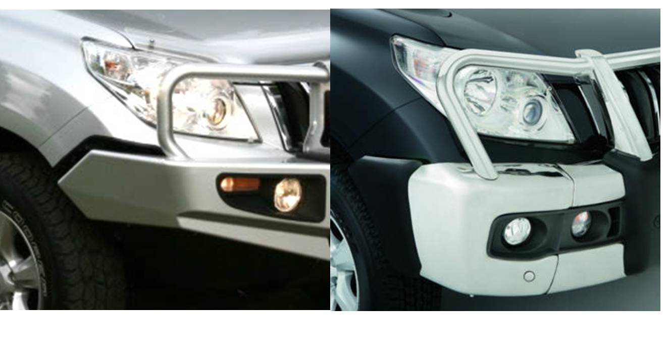

    Based on the attached I may not need a new bumper, with the cuts for the ARB bar being more severe?
    Rob
      You should be right with that, I think with the toyota bar they only cut the bottom.

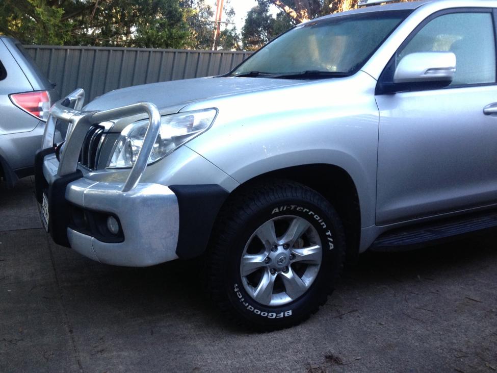

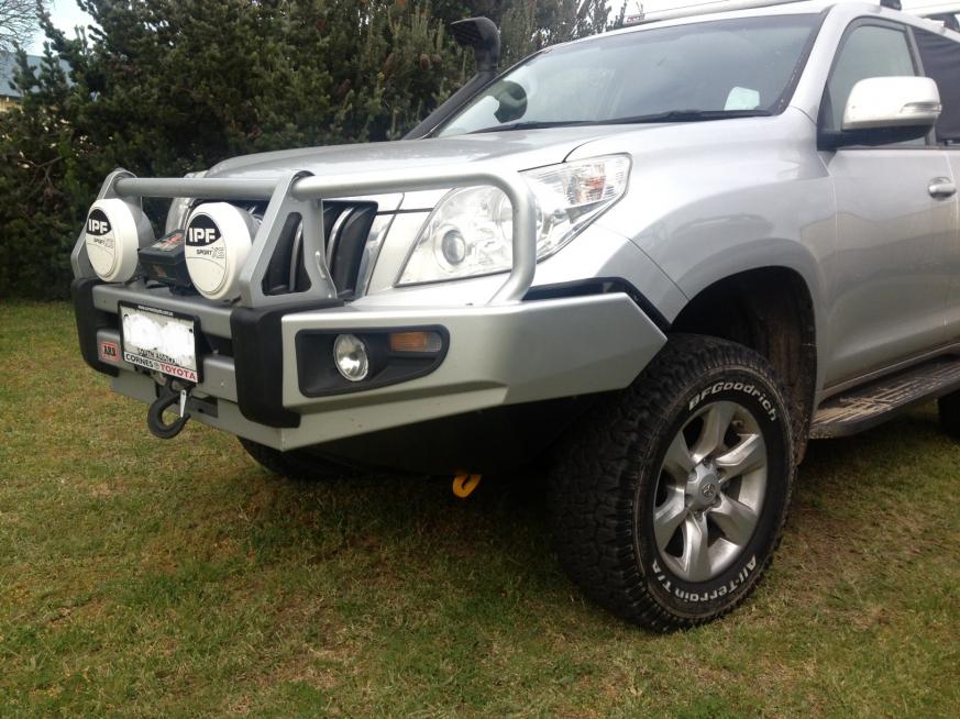

          Just closing this out for future reference. Yes you can upgrade from the Toyota factory bullbar to an ARB Winchbar without buying a new bumper. The cuts to the bumper for the ARB bar are more severe all around.
          Attached are pics of new and old.
