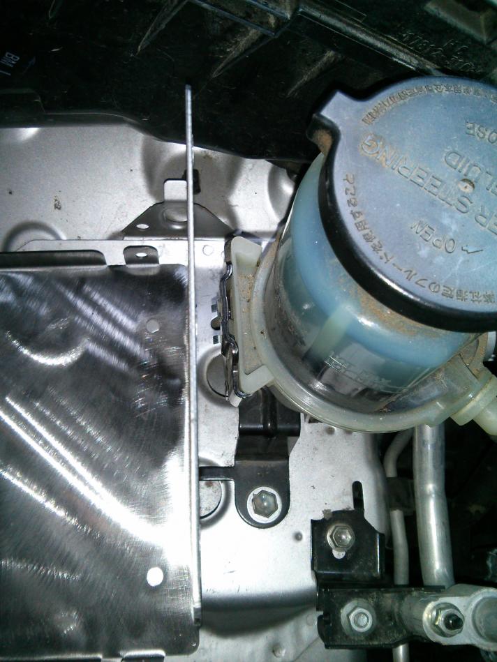

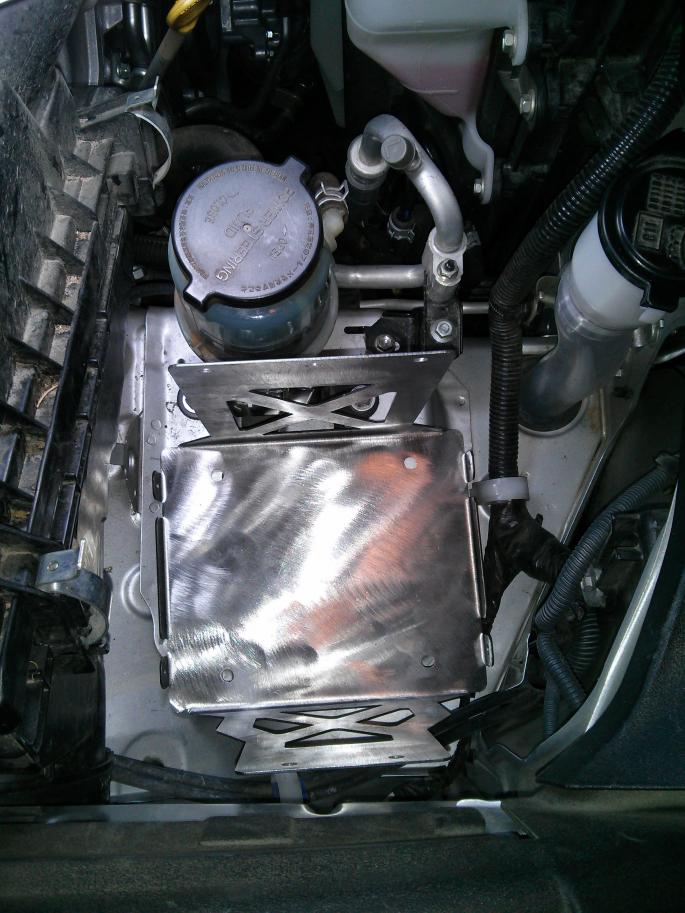

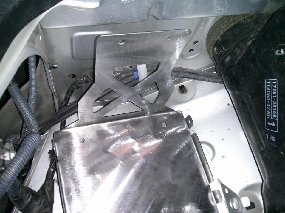

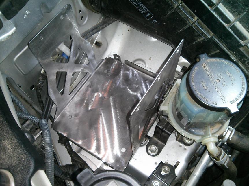

2. With minimum cost investment and lowest risk to verify if this is feasible, I have to find a battery tray to see if it can fit into the 4runner. I found a battery tray ($23) in Ebay which can fit EXACTLY under the hood. Yes, $23 only ! The supplier can modify the tray (make it compact, the lid bends upright, see photos below) without ADDITIONAL cost. This tray is thin (width X length X height) enough to fit into the slot ! No need to spend hundred dollars for the ARB battery tray !
3. Your initial investment is only $23 to see if it works before you proceed to buy those expensive items e.g. battery, isolator….

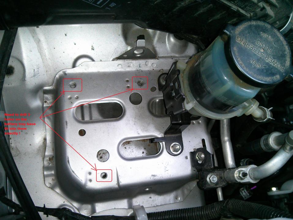

4. The challenge would be how to drill 3 holes on the base of this battery tray so that it can exactly mount on the empty slot. Stop here and think about it before go further.
