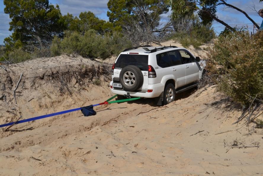

                Micheal.

                      Ok, what's a bridle ?
                      2009 KDJ120
                        Check out the picture above. The green 'strap' in this case is the bridle.
                          Also can be used as a tree trunk protector for a winch MarcL
