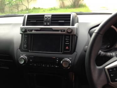

    Anyone knows how to remove the multimedia player (2014 GXL facelift model)? I want to add wire from a nose cam, but couldn't find any instructions.

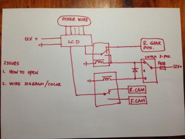

        The idea is to install a front cam inside TOYOTA logo, so I can monitor ground situation while vehicle is climbing uphills.
        dash photo and diagram attached here. Thanks heaps!

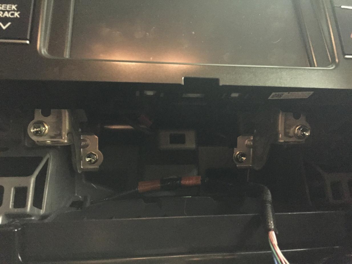

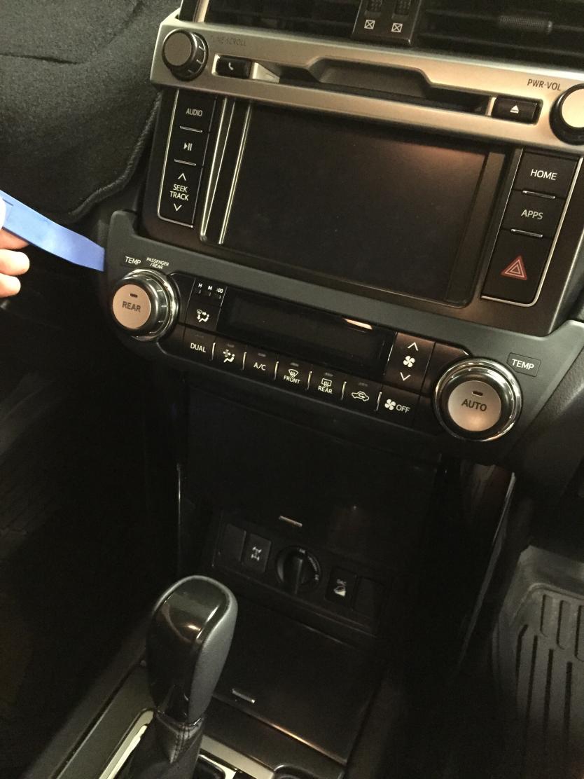

            yeah just a warning on removing major components in the middle of the dash. just check your contracts that you have signed. the death till we part one may be invoked by the bride when she sees what your doing to the car. Anyhow the Air con is a casette and if you go to the left of the cassette and place a plastic trim removal tool at the top and the bottom. The picture only shows one at the top, use both. ( near the left dial. Lever it and it will pop. work your way along and pull it out. disconnect the plugs and sit it where you will not scratch or damage it. Then a look into the recess left will show you four 10mm bolts. out they come and then light out the rest of the whole unit. lay it on a towel to prevent it being damaged. Click image for larger version

ID:	649777any dramas then let me know and I will strip mine and picture it for you. Pics should be attached to the post.
