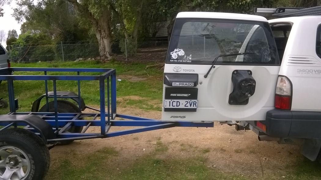

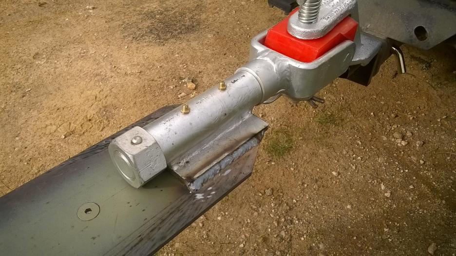

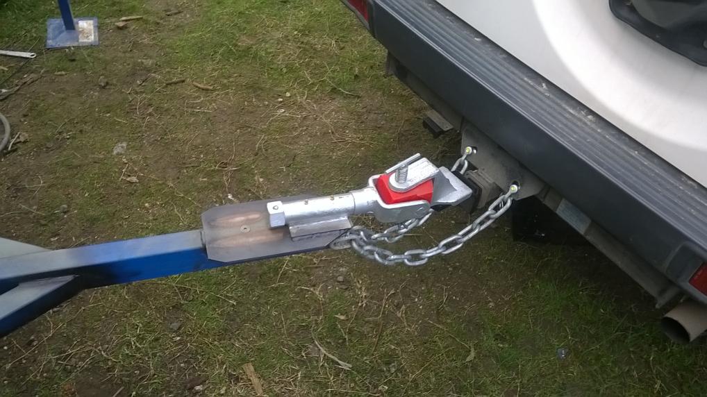

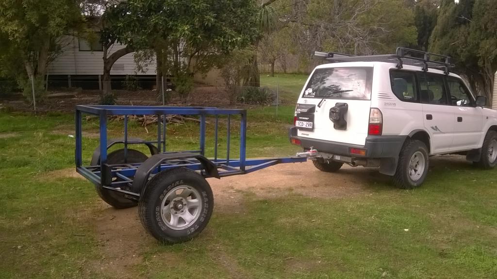

              coupling welded on, any thoughts??
                Looking good, sits nice behind the Prado.

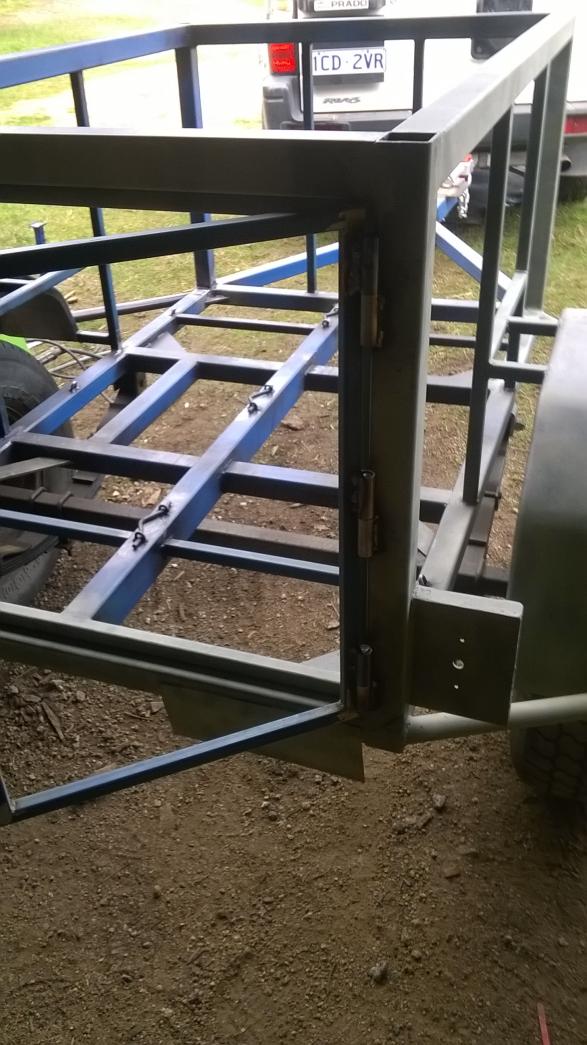

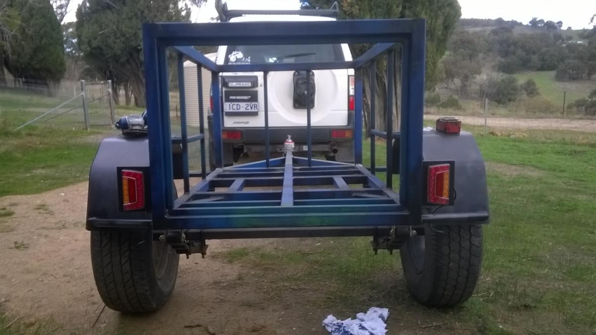

                          chains on, tiedown loops in and rear door hung!!
                          just need some good ideas for kitchen

                              The 3mm tread plate is only 25kgs , just wondering what the finish will be? painting , just a tip to save time try antisplater or change your direction of welding , less to clean later.
                              • #30
                                Thanks for tip ocean!!
