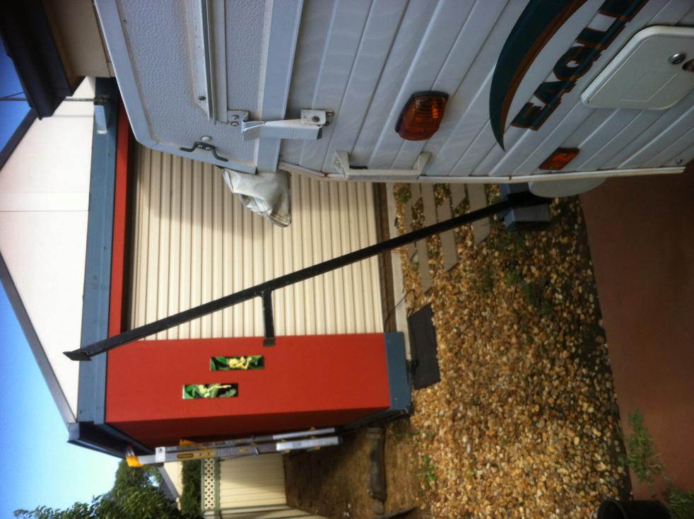

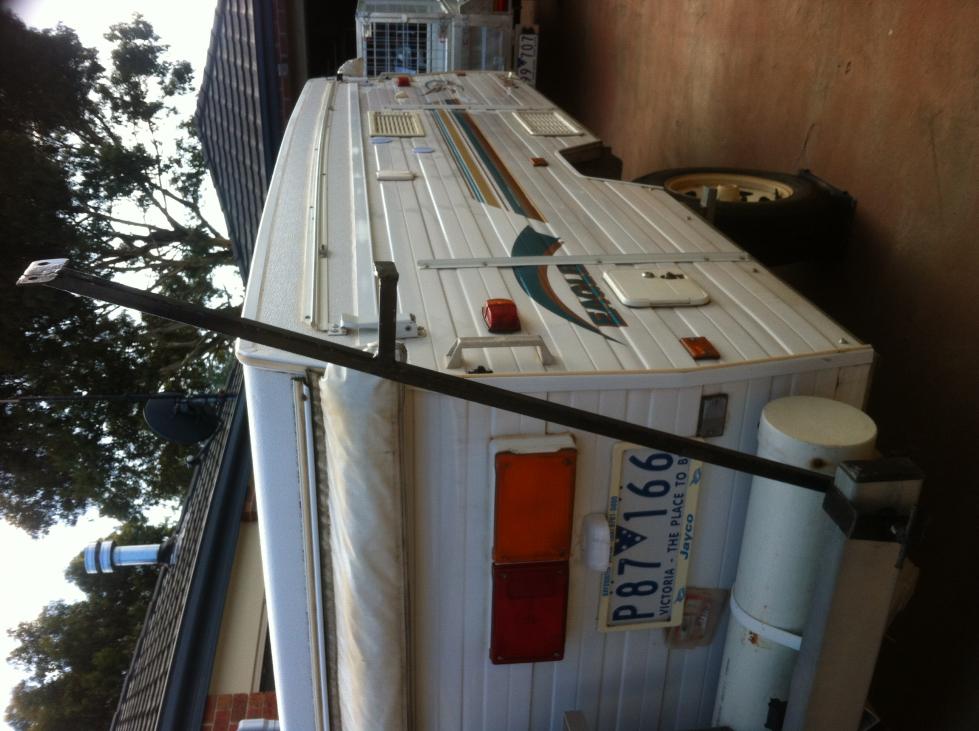

                          How did you go with mounting the joolca?
                            I made up a pole that slides on the rear bumper ( see photos) and put shower tent at rear of van, works a treat
