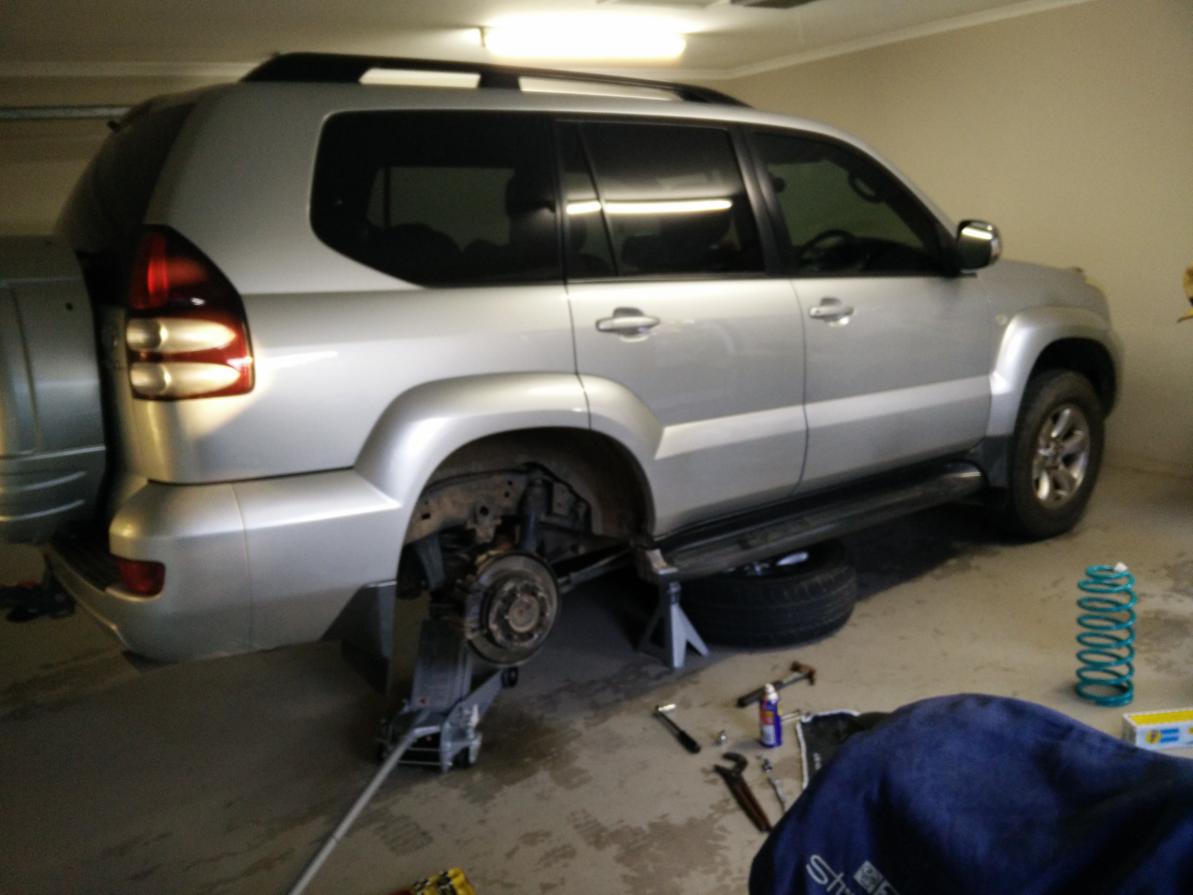

Gday guys. This site has been great for me before and after I got my 120 4 or 5 months ago. I thought I would post what I have done to her, with what goodies, and problems I ran into along the way.
I am a little impatient, so didn't really get too many, or any pics before I started my build up. But she was a bog stock 2007 v6 gxl with the sat nav/traction control/downhill assist package thingy. Around 135km on the clock back then.
This was the one pic I thought to take as I was in the midst of putting in the suspension lift kit.

Being in south east qld, and due to his reputaion, I went to Zordo for my lift, and sprung (heh) for the dobinson/billy set up. I had ordered an xrox bar and planned for a winch so he suggested the 302 springs for the front, and whatever springs I wanted for the rear. I tried the comfort springs (325) for a week, wasn't happy with them. They just didn't match the front in feel at all, and were too low. Quick call to Zordo, He knew what I was calling about before I even told him. A quick swap over at no charge/no fuss. Now I have the 327 springs, and everything is riding great.
After I installed the bull bar and winch, and after a few weeks to settle, the ride heights are as follows;
front: 802 (bottom circlip position, as recommended, out of the 4. Yes 4.)
rear: 830-845 fuel empty-full
I followed the guide I found here for the suspension install, (no spring compressors) with a few extra tips from Zordo, and everything went fine. I actually found the front easier to do than the rear. The guide and pics make it very easy.

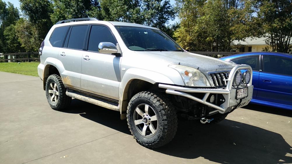

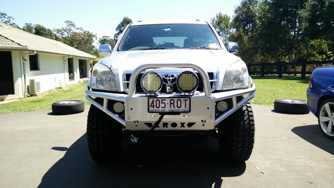

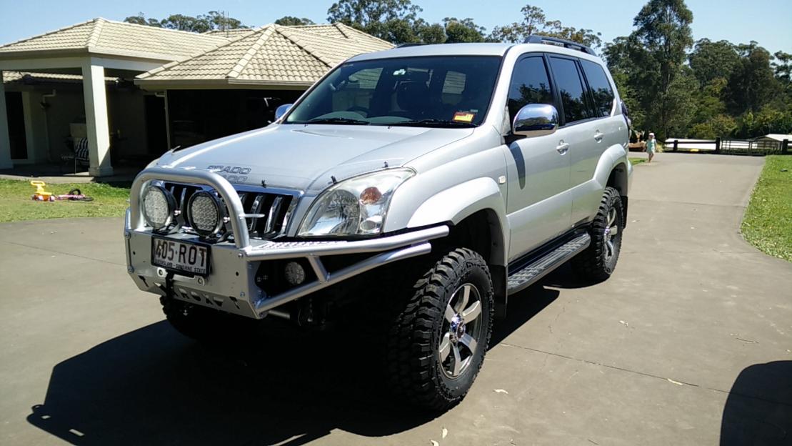

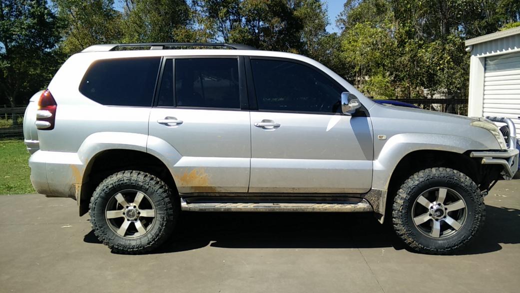

Here are some pics of whats been going on with it so far.
![Click image for larger version
